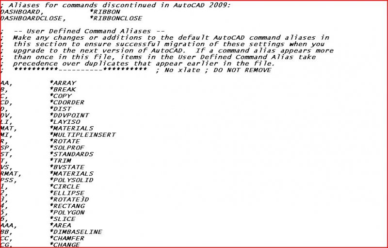

acmesriley Posted June 19, 2012 Posted June 19, 2012 I am able to edit the pgp file but after making the changes the shortcut alias's I changed will not take effect at all, not even if I exit autocad and restart. Specifically, I want 'X' to be 'EXTEND', but when I type 'X' I will get XRef instead. Also I want 'C' to be 'COPY' instead of 'CIRCLE'. These are just a couple of examples that without the shortcut my work gets not just slower but annoying by the end of my usually stressfull day. All the cad managers here where I work can not figure this out. Can any of you help me please? Thanks, acmesriley Quote

Dadgad Posted June 19, 2012 Posted June 19, 2012 Welcome to the forum. :)Did you make the changes in the USER DEFINED command aliases area of the .pgp file, as shown in the image? Did you remember to SAVE after you made the changes? Did you reboot the program, or use the REINIT command for the PGP to activate the new aliases? Remember that this area takes PRECEDENCE over duplicates that appear earlier in the file! Quote

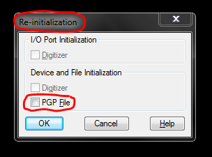

ReMark Posted June 19, 2012 Posted June 19, 2012 Just for giggles. Edit the file then save. When you go back into 2012 issue a REINIT command and make sure you check off PGP file. Now test your "C" for "Copy". What happens? By the way, you do NOT have to exit out of AutoCAD and then restart it. Just issue the REINIT command. Quote
Dadgad Posted June 19, 2012 Posted June 19, 2012 Remember that this area takes PRECEDENCE over duplicates that appear earlier in the file! Quote
acmesriley Posted June 19, 2012 Author Posted June 19, 2012 ReMark, I just went back into the pgp file and changed the body of the file to reflect C, *COPY X, *EXTEND I did a save as right overtop of the same acad.pgp file. Exited autocad and restarted. Not fixed. Quote
acmesriley Posted June 19, 2012 Author Posted June 19, 2012 Dadgad, Yes I did know that and now the pgp file has the changes I want in the main body of the file and at then end under user preferences. Not fixed yet. Quote
Dadgad Posted June 19, 2012 Posted June 19, 2012 Dadgad, Yes I did know that and now the pgp file has the changes I want in the main body of the file and at then end under user preferences. Not fixed yet. Once you change them at the bottom of the file, you will be fine. And if you don't change them there, then you will likely continue to experience this problem, until such a time as you do. Good luck. . Quote
ReMark Posted June 19, 2012 Posted June 19, 2012 Well your version of 2012 is acting way different than my version as I just tested it using "C" for "Copy" and it worked. The only edits you should be making are at the end of the file. You do NOT have to make edits to the main (original) body of the file as user defined edits trump those listed above. Quote

ReMark Posted June 19, 2012 Posted June 19, 2012 The Command Alias Editor can be found by clicking on the Express Tools tab and looking on the Tools panel for the icon labeled Command Aliases. If you utilize the drop-down menus click on Express > Tools > Command Alias Editor. If you got to the acad.pgp file via the Ribbon's Manage tab > Customization panel > Edit Aliases button then you would have to save your changes then issue the REINIT command for those changes to occur. Quote
