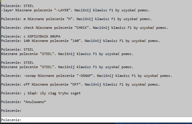

anetalaszewska Posted March 12, 2024 Posted March 12, 2024 (edited) On 6/16/2012 at 2:40 PM, Salama said: hi , this lisp is modified to calculate the quantity of steel bars as it placed on the plan of reinforcement in the form shown on the attached cad file named : steel.dwg lisp name and command : steel hope you joy it . and step by step together we improve it to fit what we want to do. steel.dwg 60.19 kB · 979 downloads steel.LSP 26.69 kB · 907 downloads Expand Hi @Salama, I know it's been quite some time since the beginning of this thread, but recently I got interested in this topic and came across your files. I downloaded the files "steel.dwg" and "steel.LSP" and saved them on my computer. I encountered errors like the ones in the picture. (Unfortunately, I have the Polish version of AutoCAD.) I'm not sure if the reason for this is that I have AutoCAD 2023 version? Are you able to help me with what I should change? Thank you in advance for your assistance and response. Edited March 12, 2024 by anetalaszewska Quote
pkenewell Posted March 12, 2024 Posted March 12, 2024 @anetalaszewska I cannot read what the errors are, but I suspect it is because this program is in english and doesn't have the needed command modifiers to automatically convert the language. Try the attached version; I went though and added all the international command modifiers. I don't know exactly what this program does, but it runs without errors at the moment. steel.LSPFetching info... Quote
