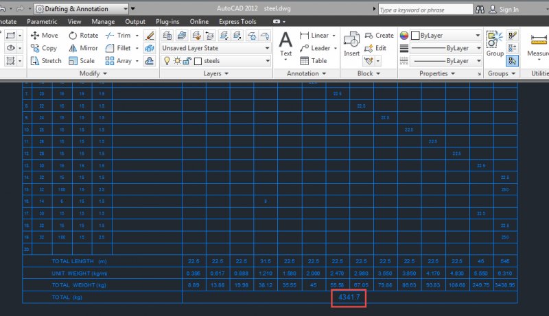

ekolman2003 Posted January 7, 2014 Posted January 7, 2014 I erased the steel quantity table and I tried the rebar lisp again. but it wasnt work.please help Quote
ymg3 Posted January 7, 2014 Posted January 7, 2014 Upload the drawing. I don't see any annotations on your Screenshot. ymg Quote
ekolman2003 Posted January 7, 2014 Posted January 7, 2014 ok.I add it rebar.dwgFetching info... Quote
ymg3 Posted January 7, 2014 Posted January 7, 2014 ekolman2003, You have changed the annotations on this drawing by removing the "[" characters. Consequently you need to change the delimiter so the program can operate. ;delimit (list "..." (chr 216) "/" "L=") ; Original case. ; ;delimit (list (chr 216) "\"" "L=") ; Yoni's case. ; ;delimit (list "[" "/" "L=") ; pyrzms's case ; delimit (list " " "/" "L=") ; ekolman's case ; Also note that in your attached drawing there are still approx. 100 annotations that are divided in two. They need to be joined together. Summary of Commands in this program: REBAR......Generates the Tables REPAIR.....Join Together Separated Annotations. NCL.........Zoom to Next Error Cloud. ECL.........Erase All Error Clouds. ymg rebar ekolman.LSPFetching info... Quote
