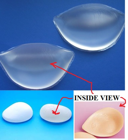

I should design a Silicone model for a Breast Cancer Survivor. My problem is the IrregularGeometric Shape of silicone. I tried "Sphere"/ "Loft" commands,but I didn't get my desired outcome! I also drew the 2D base by "Spline"; however,"Extrusion" was not a good option to make it look like a 3D silicone! Any ideas!:?

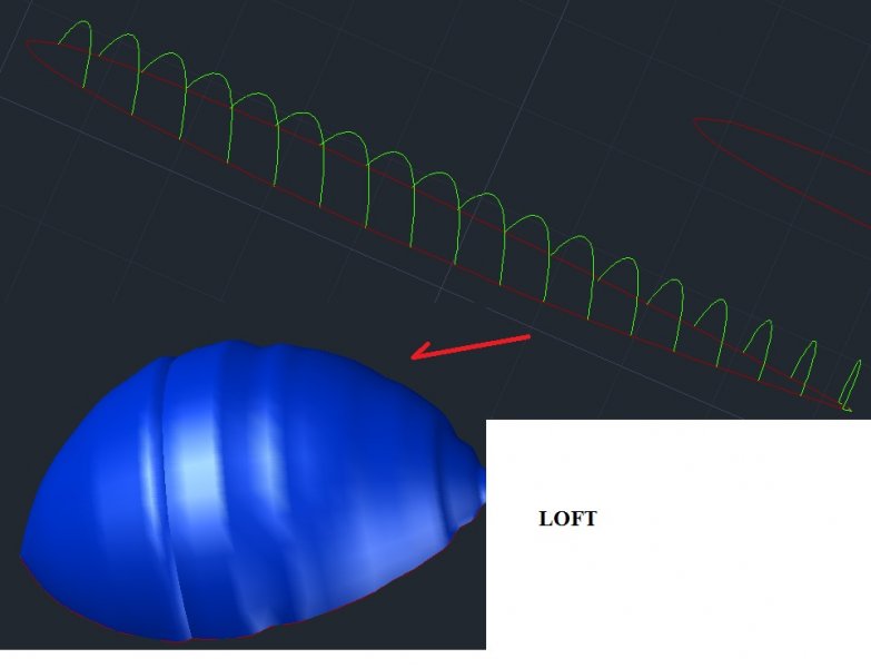

Did you use a series of profiles when you tried the LOFT command?
Have you considered the possibility of using a mesh object?
I just tried to use "Mesh Sphere" and Modify it then, and also Loft (see attachment). However, I didn't get the desired outcome.:(

I see! It becomes even more challenging for an actual size. :cry: Please keep me posted if you come out with any new idea. Thanx!

Breast implants can be round or anatomical (i.e.-teardrop, contoured or shaped). Why did you pick the one shown in your first post?

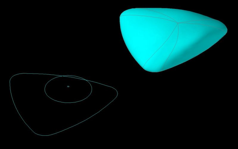

"Triangle Breast Form" is what I'mlooking for at this time. It looks more like the new image enclosed
Loft will be key.
But I think I would use something like Autodesk Inventor or Alias rather than Autodesk AutoCAD.
SolidWorks is equivalent to Inventor.
If you have access to that - I would use it rather than AutoCAD.
I think LOFT might be the way to go as well. You could try playing around with the MESH command - which is a pretty good way to form some organic shapes.
This was created using LOFT and 3 shapes.
