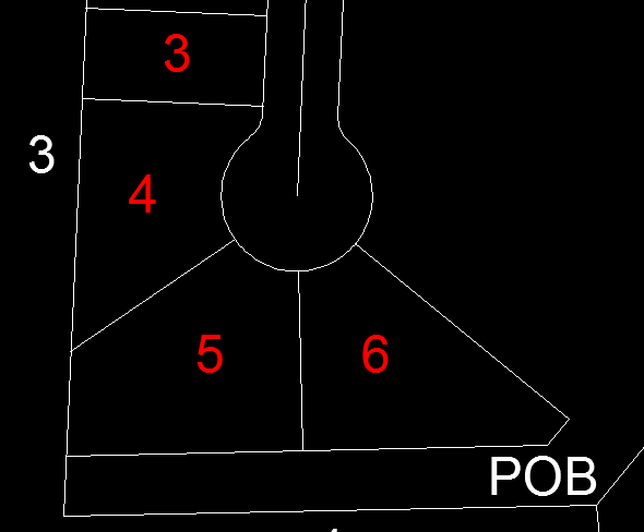

cosme017 Posted June 30, 2012 Author Posted June 30, 2012 well, I have to say. that is a great job. I can't wait to get to that point. there is something wrong with my settings, because the lines i draw are NOT registering from the bearings I put in. I have been stuck on this simple problem for days now. I have the wrong settings for the lines, because the lines I draw are not to specs of the inputted bearings. I have used the book, youtube, penn foster guides.....nothing. I know I am going to feel really dumb when I figure out the reason. the crosshair is attached to the line, and when I input the bearings, I hit enter, then I have to click the mouse to get the line, but the bearings are wrong. Quote
ReMark Posted June 30, 2012 Posted June 30, 2012 It sounds like you are zoomed so close into your drawing that it does not register with you that AutoCAD has already drawn the line. Once you click to "get the line" what you are doing, in effect, is drawing the other end of a line that is connected back off screen where you can't see it. Do you have Skype and a video camera hooked to your computer? Yes or No? You do realize that when you draw a line with a distance and bearing you start by clicking on a known point. ONCE THE DISTANCE AND BEARING ARE TYPED ON THE COMMAND LINE AND YOU PRESS THE ENTER KEY THE LINE HAS BEEN DRAWN. There is nothing further to do. The mouse doesn't even have to be in your hand because AutoCAD finishes the line command for you. Quote

cosme017 Posted June 30, 2012 Author Posted June 30, 2012 when i input the bearings, hit enter, then next point, 113..., No line is drawn, in fact I would go through all the bearings (4) after the reference line and still the lines are not drawing. I see 1 line from the benchmark, but when I put in the bearings 113...the line does not move. it stays attached to the crosshairs. this is the same problem i have been having since day one. the line does not draw. I move to move the line in the direction it says and click the mouse then a line draws but it is the wrong bearings. Quote

ReMark Posted June 30, 2012 Posted June 30, 2012 Continuing on the student is instructed to create lots 4, 5 and 6. The northern boundary of the buffer area between the back of lots 5 and 6 and SW Kensington Place is also created. Note that the property lines between lots 4/5, 5/6 and the east property line of lot 6 all extend from their origins to the edge of the cul-de-sac. If each were extended they would terminate at the center of the cul-de-sac thus making them very easy to construct. Quote
