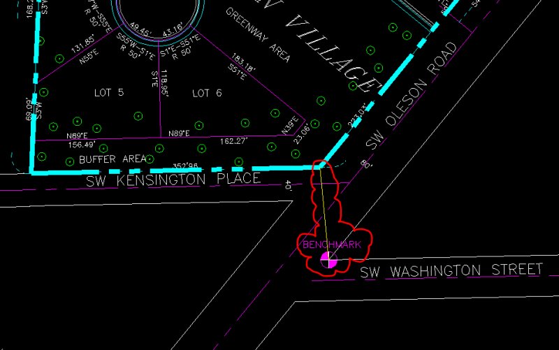

ReMark Posted June 27, 2012 Posted June 27, 2012 The benchmark is located at the intersection of the north streetline of SW Washington Street and the east streetline of SW Oleson Road. The line you are being instructed to draw will take you to the intersection of the west streetline of SW Oleson Road and the north streeline of SW Kensington Place. It is only a reference line to get you across the street (SW Oleson Road) to a very important streetline intersection where the real work of creating the subdivision property lines begin. Quote

cosme017 Posted June 27, 2012 Author Posted June 27, 2012 ok, well the line is attached from the center of the crosshair and it is pointing down (stiff), and i place it around the 11 but the line just goes from the crosshair straight down. It doesnt even look like a boundary line. from the screen shots the line should have some angle on it. Quote
ReMark Posted June 27, 2012 Posted June 27, 2012 The yellow line surrounded by the red "cloud" is the one you are being instructed to draw. Since it is only to be used as a reference it would not appear in the final drawing. Quote

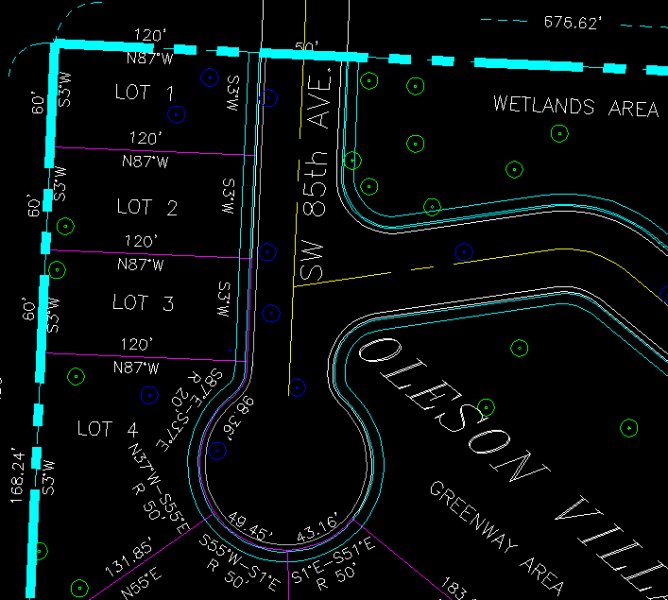

ReMark Posted June 27, 2012 Posted June 27, 2012 The instructions (page 5) clearly state that the point of beginning (POB) of this survey is measured from the benchmark and then it goes on to state the distance and bearing which you previously noted. The next four lines you draw will be the boundary of the subdivision. They go in a counter-clockwise direction starting with the one on the west, then the north, the east and finally the south. The last line takes you back to your starting point. Quote
ReMark Posted June 27, 2012 Posted June 27, 2012 After you draw the subdivision boundary your next task will be to create lots 1, 2 and 3. This is covered on page 6. Next comes the cul-de-sac (the upside-down lollipop) you see near the bottom of the above image. Quote
cosme017 Posted June 27, 2012 Author Posted June 27, 2012 i'll tell you I know i am missing something. the line draws straight down from the crosshairs, so it points south from the crosshairs. I must not of checked something on or off. this is weird. Quote

ReMark Posted June 27, 2012 Posted June 27, 2012 cosme017 said: i'll tell you I know i am missing something. the line draws straight down from the crosshairs, so it points south from the crosshairs. I must not of checked something on or off. this is weird. Maybe you typed the bearing in as "S" for south instead of "N" for north. Remember you are starting at the center of the benchmark and going northwest (up and ever so slightly to the left). Quote
