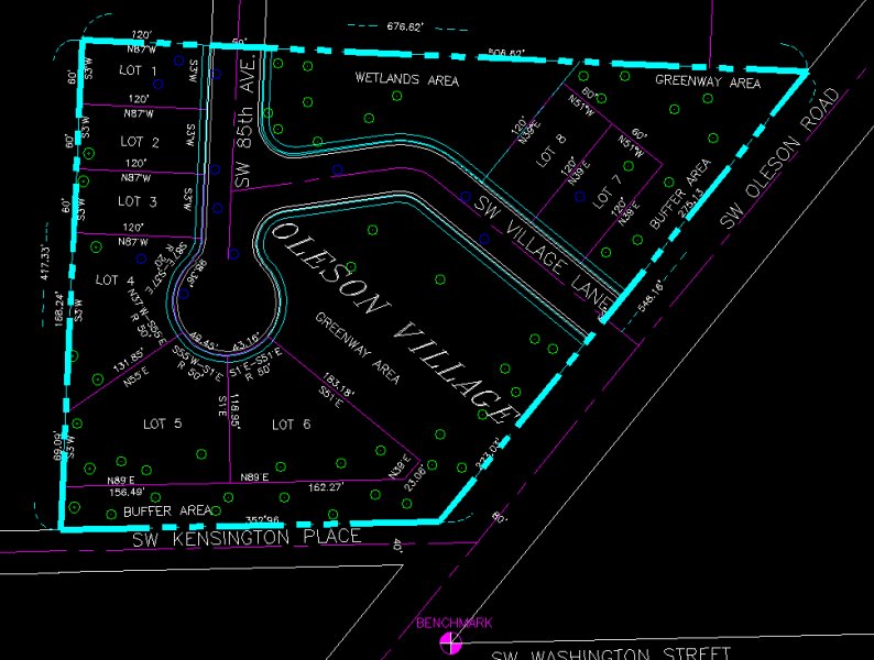

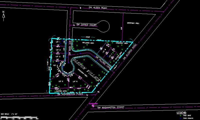

ReMark Posted June 25, 2012 Posted June 25, 2012 I'm assuming you've seen this image that was posted in a previous thread. It should give you some idea of what you need to accomplish. Quote
ReMark Posted June 25, 2012 Posted June 25, 2012 Here's a closeup view of the subdivision. Notice the benchmark near the bottom of the image. Quote
cosme017 Posted June 25, 2012 Author Posted June 25, 2012 Yes, i have seen this via another student. I printed it for reference. I see the benchmark, but i'm not sure how to draw that symbol. I will check my textbook today. Quote
ReMark Posted June 25, 2012 Posted June 25, 2012 Use any method you prefer. It could be done in a couple different ways. A circle with a cross in it and two hatched quadrants would work. Quote
cosme017 Posted June 25, 2012 Author Posted June 25, 2012 How do the coordinates to place the benchmark. Type in coordinates, then draw the benchmark? Quote
ReMark Posted June 25, 2012 Posted June 25, 2012 First locate where the benchmark has to go in the drawing using the provided coordinates then draw your symbol. I'd recommend making it a block but I can't recall if that is required. Quote
