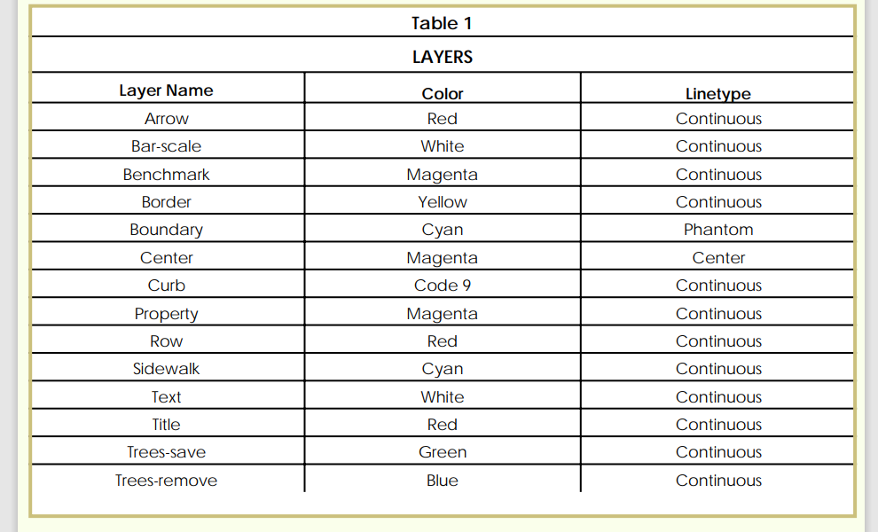

ReMark Posted July 24, 2022 Share Posted July 24, 2022 Here is the table of Layers as specified for the Oleson Village project in the recent past. It is possible that P-F made some changes that I am unaware of. Quote Link to comment Share on other sites More sharing options...

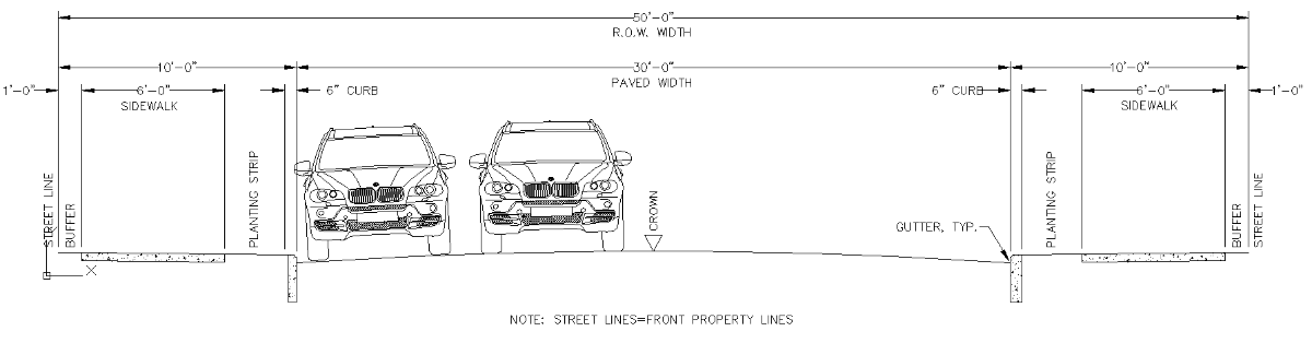

ReMark Posted July 25, 2022 Share Posted July 25, 2022 (edited) This is a cross-section of a street line Right-of-Way. Note that the buffer, planting strip and curb are located between the ROW lines and not outside of them. Edited July 25, 2022 by ReMark Changed image to B/W Quote Link to comment Share on other sites More sharing options...

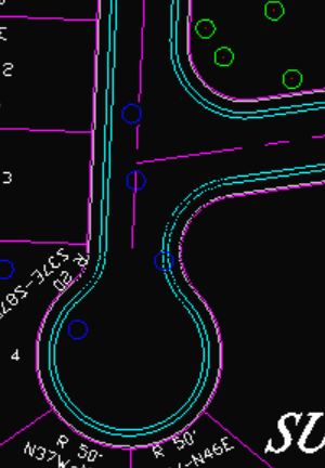

ReMark Posted July 25, 2022 Share Posted July 25, 2022 This is a closeup view of the intersection of SW 85th Ave. and SW Village Lane. Quote Link to comment Share on other sites More sharing options...

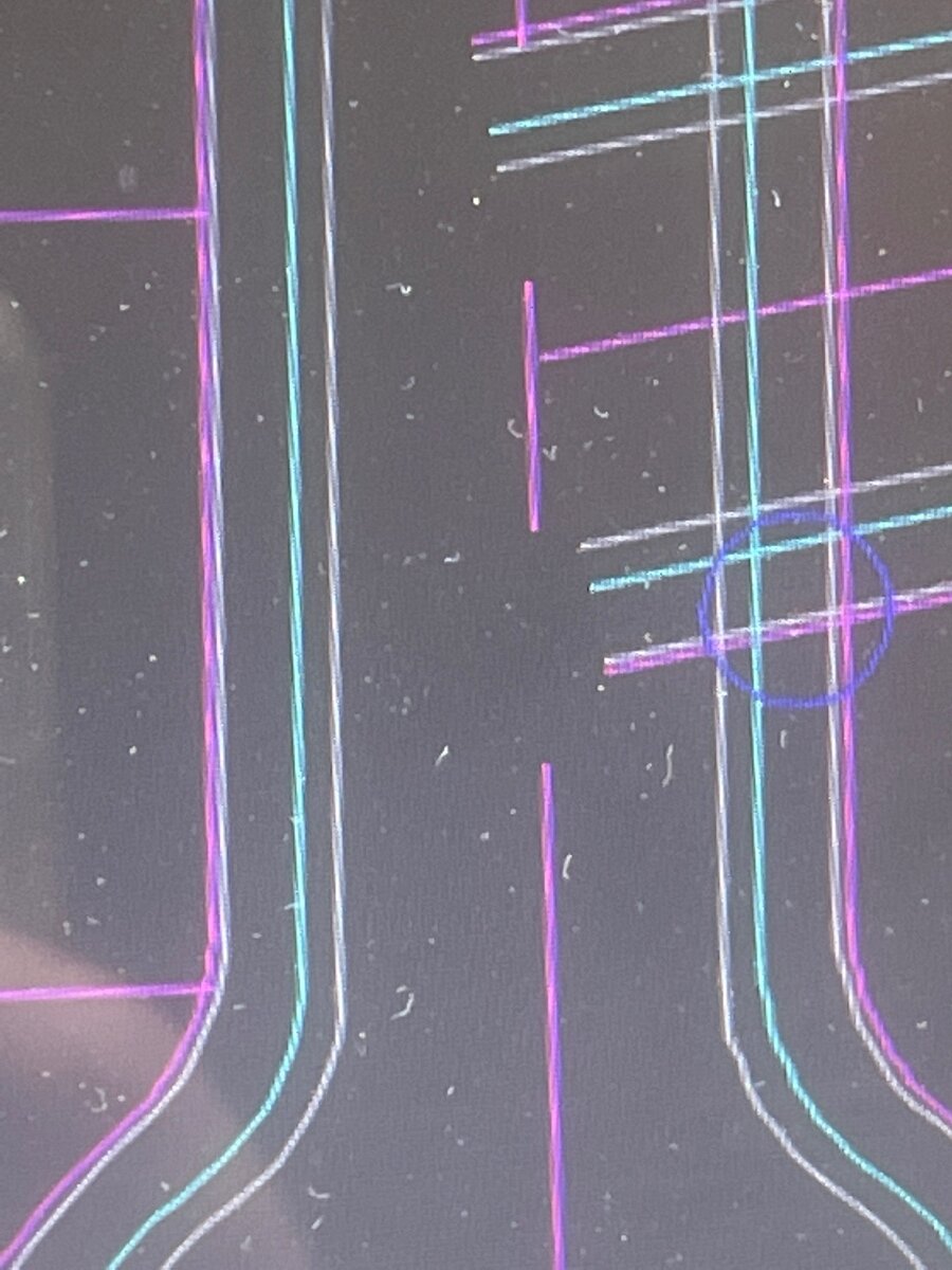

Torbone Posted July 25, 2022 Share Posted July 25, 2022 8 hours ago, ReMark said: This is a closeup view of the intersection of SW 85th Ave. and SW Village Lane. the last line inside borders you have cyan for sidewalk. the last inside line is curb, it should be gray 9 color for curb. it shows on my directions. tue buffer is also gray. Can i leave mine rhat way or has be 2 cyan border lines? Quote Link to comment Share on other sites More sharing options...
ReMark Posted July 25, 2022 Share Posted July 25, 2022 (edited) Should be color 9 - gray. But that color doesn't stand out as well... thus the reason for the cyan color. Property lines should be trimmed where they meet the street line and your curves don't appear to be smooth. What happened? Edited July 25, 2022 by ReMark Quote Link to comment Share on other sites More sharing options...
Torbone Posted July 25, 2022 Share Posted July 25, 2022 1 hour ago, Torbone said: the last line inside borders you have cyan for sidewalk. the last inside line is curb, it should be gray 9 color for curb. it shows on my directions. tue buffer is also gray. Can i leave mine rhat way or has be 2 cyan border lines? i am not done trimming with Village ave yet. also when i went to fillet the corner where u see blue tree, it is saying to large an area to fillet . the other side was fine. the radius curves are not smooth, not sure why. Does that represent something wrong i did? i used off set to create inside circles, it was easier. I did not off set the curves though! maybe when i zoom out they will adjust normal . Quote Link to comment Share on other sites More sharing options...
ReMark Posted July 25, 2022 Share Posted July 25, 2022 (edited) They do not look tangent to each other at the point where one curve intersects with another. Send me a copy of your drawing as it currently exists. Remember to do a "save as" and select the AutoCAD 2010 file format. I have about 40 minutes to kill before I must leave. Time now: 6:10 pm. Edited July 25, 2022 by ReMark Quote Link to comment Share on other sites More sharing options...
