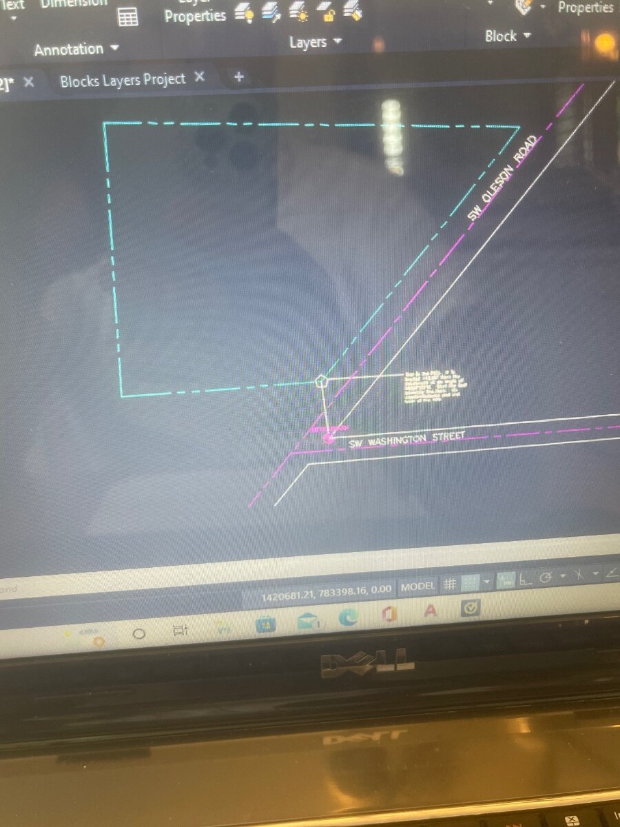

Torbone Posted July 17, 2022 Posted July 17, 2022 here is second line at pob. see length! why is it so long. Quote
ReMark Posted July 17, 2022 Posted July 17, 2022 My guess it is your input is not correct. By the way, even your starting coordinates for the benchmark appear to be wrong. The line that goes FROM the benchmark to the POB should have starting coordinates of X=1421334.93, Y= 783207.62 and ending coordinates of X=1421324.12, Y=783320.76. I am going to send you a private message shortly. Read it and respond accordingly. Quote

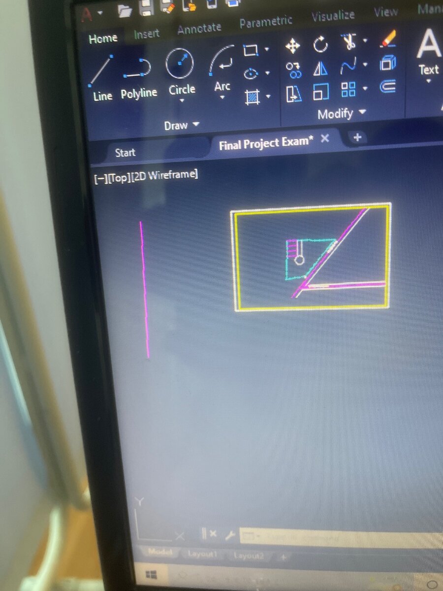

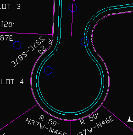

Torbone Posted July 20, 2022 Posted July 20, 2022 On 7/18/2022 at 6:38 PM, ReMark said: Finally! Good job. Now keep going. Expand Mark, I am drawing the center line for Cul-de-sac for SW 85 Ave. see photo. The Coordinates are ofd with drawing. see line to left of the drawing. why? the drawing limits are off or something? i verified, they were not. Quote
ReMark Posted July 20, 2022 Posted July 20, 2022 Honestly that image is so small and out of focus I cannot discern the problem. Are you using your phone to take pictures of your screen? What version of Windows are you running? Are you aware of a feature called the "Snipping Tool" that is a feature of Windows? Here is an example of what it is capable of... Quote
Torbone Posted July 20, 2022 Posted July 20, 2022 magenta line to left . u cant see that? why would my coordinates be off is what i asked. Quote

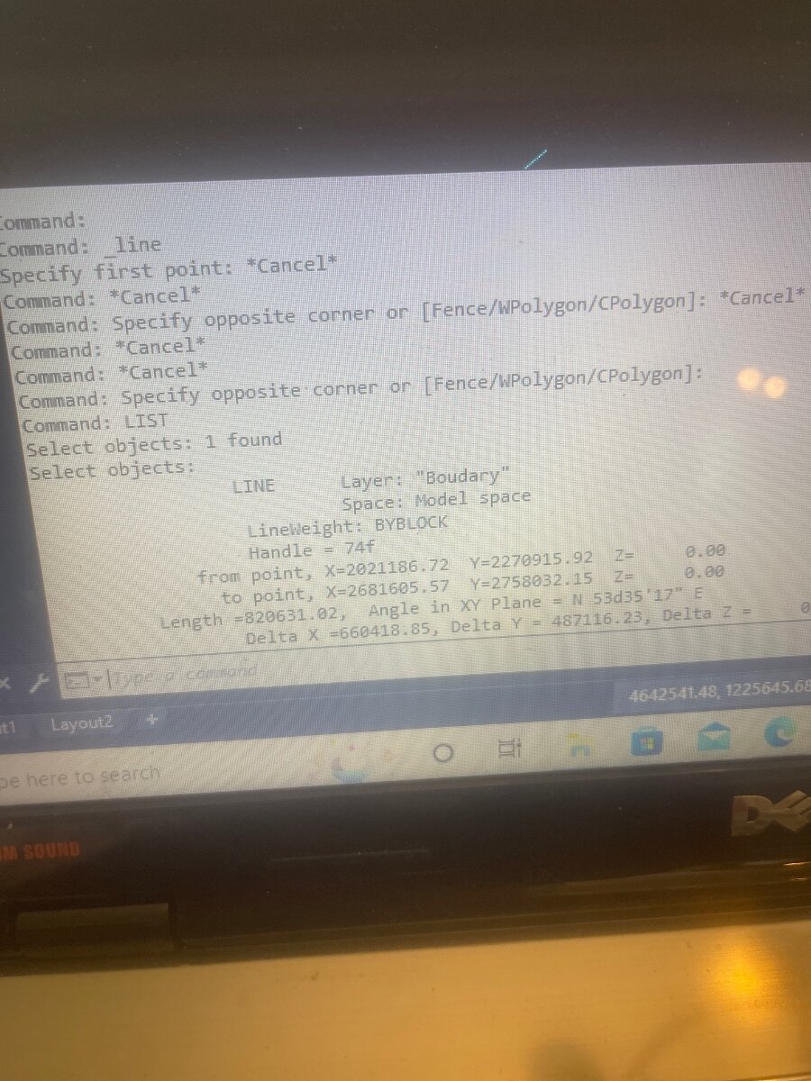

ReMark Posted July 20, 2022 Posted July 20, 2022 (edited) I thought that was just a stray line you might be using for some reason. Draw a diagonal line from the lower lefthand corner of your drawing to the upper righthand corner. Make sure you are picking the outer most lines (white). What are the starting and ending coordinates? What are the starting/ending coordinates of the magenta line? BTW... what was the magenta line supposed to represent? I'm not sure what is taking so long but.... the starting X/Y coordinates for the diagonal line should be 1420481.09, 782918.89 and the ending X/Y coordinates should be 1422281.09, 784118.89. If you do not find your coordinates match these then your drawing is incorrect. Edited July 20, 2022 by ReMark Quote
ReMark Posted July 20, 2022 Posted July 20, 2022 (edited) On 7/20/2022 at 9:58 PM, Torbone said: magenta line to left . u cant see that? why would my coordinates be off is what i asked. Expand They could be off because you 1) entered them wrong, 2) your drawing is incorrectly located within the limits as called for in the instructions (i.e. - you entered the wrong coordinates), or 3) you have the base angle (East) located in the wrong direction. I think you should just delete the drawing and start all over again. Follow the directions I give in this thread (with 409 posts). Edited July 20, 2022 by ReMark Quote
Torbone Posted July 21, 2022 Posted July 21, 2022 The drawing is not located correctly in limits is issue. i can select all of it and bring it back. zoom extents makes it disappear off screen, so something is off. I will check it later today. thanks again Quote
ReMark Posted July 21, 2022 Posted July 21, 2022 That does not explain the magenta line you said was incorrectly located. Issue the LIMITS command and post the coordinates here. Quote
Torbone Posted July 21, 2022 Posted July 21, 2022 On 7/21/2022 at 10:51 AM, ReMark said: That does not explain the magenta line you said was incorrectly located. Issue the LIMITS command and post the coordinates here. Expand Limits are 0,0 2000000,2000000. Magenta line is center line for 85 w ave into cul-de-sac. drawing centerline for village road is off. i can draw that w correct coords, and then move drawing to that, to get it in vicinity and then get it correct. i should not have to redraw all . i will try it later. thanks Quote
ReMark Posted July 21, 2022 Posted July 21, 2022 (edited) And what are the start/end coordinates of the magenta line which you say is the centerline of SW 85th Ave? If the entire drawing is off then you can move it to the correct position using the coordinates of the benchmark. The benchmark X/Y coordinates are 1421334.93,783207.62. Edited July 21, 2022 by ReMark Quote
