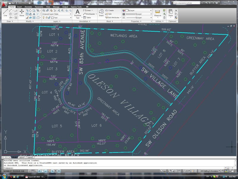

chovek Posted December 7, 2012 Share Posted December 7, 2012 I hope that is good enough Quote Link to comment Share on other sites More sharing options...
ReMark Posted December 7, 2012 Share Posted December 7, 2012 Maybe it's my eyes or maybe it's the image but something doesn't look quite right with a couple of the curves on SW Village Lane. But other than that it looks pretty good. Can I ask one more favor? Can I see a close up of the SW 85th Avenue cul-de-sac? Quote Link to comment Share on other sites More sharing options...
chovek Posted December 7, 2012 Share Posted December 7, 2012 ........ Quote Link to comment Share on other sites More sharing options...
ReMark Posted December 7, 2012 Share Posted December 7, 2012 It looks like you have the sidewalk inside the streetline and the "parking strip" on the outside of the streetline. Am I correct? Quote Link to comment Share on other sites More sharing options...
