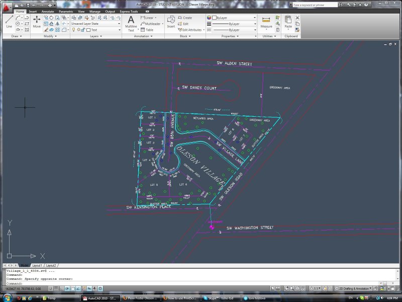

chovek Posted December 6, 2012 Share Posted December 6, 2012 yes ,I get 100 ,thank you and I'm very grateful for this forum Quote Link to comment Share on other sites More sharing options...
ReMark Posted December 6, 2012 Share Posted December 6, 2012 Congratulations on your perfect score. Maybe you can post an image or two? You can also volunteer to answer other students questions while I go fishing! LoL Quote Link to comment Share on other sites More sharing options...
chovek Posted December 6, 2012 Share Posted December 6, 2012 I tried but I do not get in I'll try again later Quote Link to comment Share on other sites More sharing options...
ReMark Posted December 6, 2012 Share Posted December 6, 2012 Please do. I like to see students' work. Thanks. Quote Link to comment Share on other sites More sharing options...
chovek Posted December 6, 2012 Share Posted December 6, 2012 is that ok Quote Link to comment Share on other sites More sharing options...
ReMark Posted December 6, 2012 Share Posted December 6, 2012 Looks pretty good. Can I get a close up of the subdivision itself? Quote Link to comment Share on other sites More sharing options...
