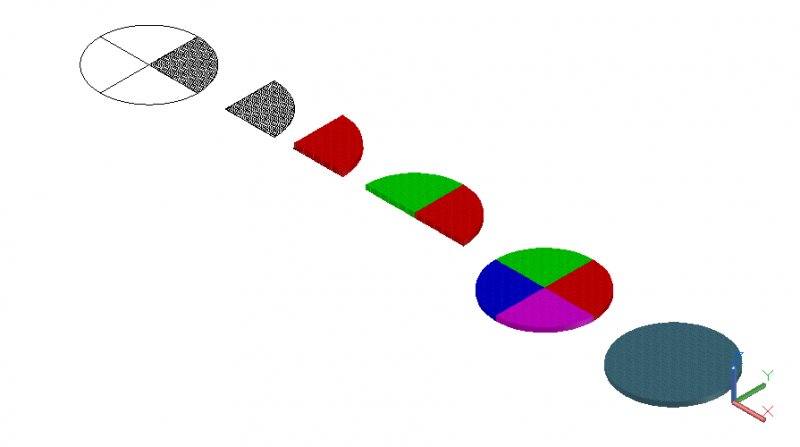

ReMark Posted June 13, 2012 Posted June 13, 2012 From upper left to lower right. 2D preliminary layout 2D quarter 3D quarter after using EXTRUDE & SUBTRACT commands 3D half after using Mirror command 3D full after using Mirror command 3D solid model after using UNION command Popcorn is extra. Quote
pleasehelp Posted June 13, 2012 Author Posted June 13, 2012 so.. i tried to make a quarter circle with the circles arrayed, and make it a 'region', extrude the quarter-disk. Then i started subtracting all the circles a few circles at a time. now i seem to have reached a max threshold and i can't subtract any more. does anyone know what the max number of subtractions allowed in autocad? but THANK YOU SO MUCH for all your help!!! Quote
ReMark Posted June 13, 2012 Posted June 13, 2012 I know of no such limitation. You shouldn't be having any problems using AutoCAD 2012 because that's the program I used. Maybe your procedure is flawed. If you want to use the REGION command then do the subtraction while everything is 2D but AFTER running REGION. It should work with no problem. Then you do the EXTRUDE next. Done. What are the specs on your computer? Is it a laptop by any chance? Quote

nestly Posted June 13, 2012 Posted June 13, 2012 In response to the question about the maximum number of subtractions, which I also raised in the other thread The answer seems to be "Yes" (or at least "maybe") When Solid History is turned on (SOLIDHIST=1) I could not even subtract 1/4th of the total number of small cylinders in a single operation. The more holes I put in the disc, the fewer subtractions I could do without AutoCAD complaining. By the time I got down to the end, I could only subtract 5 or 6 small cylinders at once. However, I was able to subtract all 1650 small cylinders from the complete disc as single operation after recreating everything with SOLIDHIST = 0 (OFF) Quote

pleasehelp Posted June 14, 2012 Author Posted June 14, 2012 In response to the question about the maximum number of subtractions, which I also raised in the other thread The answer seems to be "Yes" (or at least "maybe") When Solid History is turned on (SOLIDHIST=1) I could not even subtract 1/4th of the total number of small cylinders in a single operation. The more holes I put in the disc, the fewer subtractions I could do without AutoCAD complaining. By the time I got down to the end, I could only subtract 5 or 6 small cylinders at once. However, I was able to subtract all 1650 small cylinders from the complete disc as single operation after recreating everything with SOLIDHIST = 0 (OFF) thanks!! how do i turn solidhist off? Quote
pleasehelp Posted June 14, 2012 Author Posted June 14, 2012 I got it to work by doing everything in 2D, then EXTRUDEing everything at once, then SUBTRACTing the small cylinders in "chunks" (AutoCAD complained if I tried to do to many at once see below) I have no idea what at "brep" is? It does seem to take a fair amount of horsepower (although the computer I did this on isn't a exactly a powerhouse.) SUBTRACT Select solids, surfaces, and regions to subtract from .. Select objects: 1 found Select objects: The maximum number of history nodes in a solid would be exceeded. You may want to convert the solid to a brep. [ATTACH=CONFIG]35358[/ATTACH] Nesty, this is AWESOME!! I can't seem to get it though.. i tried attaching the file that i have so far, but its over the permitted limit. Quote
nestly Posted June 14, 2012 Posted June 14, 2012 Type SOLIDHIST at the command line. 0 = OFF Disabling SOLIDHIST does not remove history from existing solids, it only means there will be no history recorded for new solids. Quote
pleasehelp Posted June 14, 2012 Author Posted June 14, 2012 Type SOLIDHIST at the command line. 0 = OFF Disabling SOLIDHIST does not remove history from existing solids, it only means there will be no history recorded for new solids. hi turned off solidhist. getting this error: "The maximum number of history nodes in a solid would be exceeded. You may want to convert the solid to a brep." Quote
pleasehelp Posted June 14, 2012 Author Posted June 14, 2012 hi turned off solidhist. getting this error: "The maximum number of history nodes in a solid would be exceeded. You may want to convert the solid to a brep." got it! done and done!! Thank you EVERYONE for all the help!!!! mad respect!! Quote

Dadgad Posted June 14, 2012 Posted June 14, 2012 [ATTACH=CONFIG]35366[/ATTACH]From upper left to lower right. 2D preliminary layout 2D quarter 3D quarter after using EXTRUDE & SUBTRACT commands 3D half after using Mirror command 3D full after using Mirror command 3D solid model after using UNION command Popcorn is extra. ReMark, nice graphic and methodical approach, but what happens when a hole falls on one of the quadrant lines, if it isn't dead center? I believe that where you stitch it together you will run into spacing problems too, between hole centers on adjacent quadrants. Quote
ReMark Posted June 14, 2012 Posted June 14, 2012 I had no problem with the holes that fell on the quadrant lines. Quote
