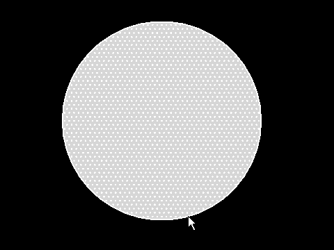

pleasehelp Posted June 12, 2012 Share Posted June 12, 2012 hi all, i've explained my situation below. Any help would be GREATLY appreciated! i need to make a 'stencil' of sorts that is a solid 1.5mm thick disk (about 30mm in diameter) with 200um holes (separated by 500um - i.e. 500um distance between each hole) Things I've tried: I tried to make a 2D footprint of this stencil and then extrude the entire thing. My computer crashed! i guess the ram needed for this is too much. I made a 200um diameter circle, extruded it into a 1.5mm 'pillar', arrayed these pillars, then placed a 30mm diameter, 1.5mm high solid disk around the array and made a block. When i exported it to an stl format, it didn't recognize the design as a disk with holes, but as an array of pillars.. argh!!! I tried to make the disk first. draw one 200um circle and presspull it to form one hole - but i can't seem to array that hole in this disk!! ARGH!!!!! If I have to make an array of these circles and presspull them one at a time, i'll die before i finish the stencil. What to do? What to do?? I'm at my wits' end! Thank you much for any help!! Quote Link to comment Share on other sites More sharing options...

ReMark Posted June 12, 2012 Share Posted June 12, 2012 Break it down. Draw one quarter of the disk and holes that go with it in 2D. Use the REGION command followed by the SUBTRACT command. Mirror the quarter disk. Union. Copy that. Rotate it and align it with the first half. Union the two halves. Quote Link to comment Share on other sites More sharing options...

nestly Posted June 12, 2012 Share Posted June 12, 2012 I got it to work by doing everything in 2D, then EXTRUDEing everything at once, then SUBTRACTing the small cylinders in "chunks" (AutoCAD complained if I tried to do to many at once see below) I have no idea what at "brep" is? It does seem to take a fair amount of horsepower (although the computer I did this on isn't a exactly a powerhouse.) SUBTRACT Select solids, surfaces, and regions to subtract from .. Select objects: 1 found Select objects: The maximum number of history nodes in a solid would be exceeded. You may want to convert the solid to a brep. Quote Link to comment Share on other sites More sharing options...

Dadgad Posted June 13, 2012 Share Posted June 13, 2012 (edited) Like above extrude one cylinder array and clean up, then extrude your 30mm disk then try subtract this should leave holes. Do cyl's on a layer, disk on another use FILTER pick cylinders, then subtract "P" for previous if I ma right it will give desired answer. If you post wrong leave a post to moderator who will fix up. BIGAL's way should work fine, but wouldn't it be easier to just ARRAY the circles and then PRESSPULL the disc (as opposed to the holes) ? PRESSPULL defines the bounded area and does not include the circles, so when you pull it you are done holes predrilled. Then you probably want to erase all of the circles, which is a piece of cake. Edited June 13, 2012 by Dadgad Quote Link to comment Share on other sites More sharing options...
nestly Posted June 13, 2012 Share Posted June 13, 2012 .....but wouldn't it be easier to just ARRAY the circles and then PRESSPULL the disc Did you ever try to PRESSPULL a Circle with nearly 2000 smaller circles arrayed inside of it? Quote Link to comment Share on other sites More sharing options...

SEANT Posted June 13, 2012 Share Posted June 13, 2012 BREP is short for Boundary Representation. AutoCAD includes some basic parametric features while creating primitive type solids (Cylinders, Boxes, Cones, etc.), as well as History features associated with Boolean operations. A solid that maintains those features requires a lot of additional overhead. AutoCAD’s BREP command will remove the Parametric/History information, leaving just the “dumb” solid – similar to what was available from, say, AutoCAD 2000. Quote Link to comment Share on other sites More sharing options...
nestly Posted June 13, 2012 Share Posted June 13, 2012 Thanks SEANT. So it's likely I could have done the subtraction in one operation (or at least fewer operations) if solid history wasn't turned on? Quote Link to comment Share on other sites More sharing options...
ReMark Posted June 13, 2012 Share Posted June 13, 2012 I created just one quarter of the disk then used the MIRROR command (twice) to fill in the remaining three quarters. Finished it all off with the UNION command. No Brep encountered. Quote Link to comment Share on other sites More sharing options...
SEANT Posted June 13, 2012 Share Posted June 13, 2012 Thanks SEANT. So it's likely I could have done the subtraction in one operation (or at least fewer operations) if solid history wasn't turned on? Perhaps, though that process has a lot of complexity even without history. It sounds like ReMark’s divide and conquer process is a workable alternative. Quote Link to comment Share on other sites More sharing options...
