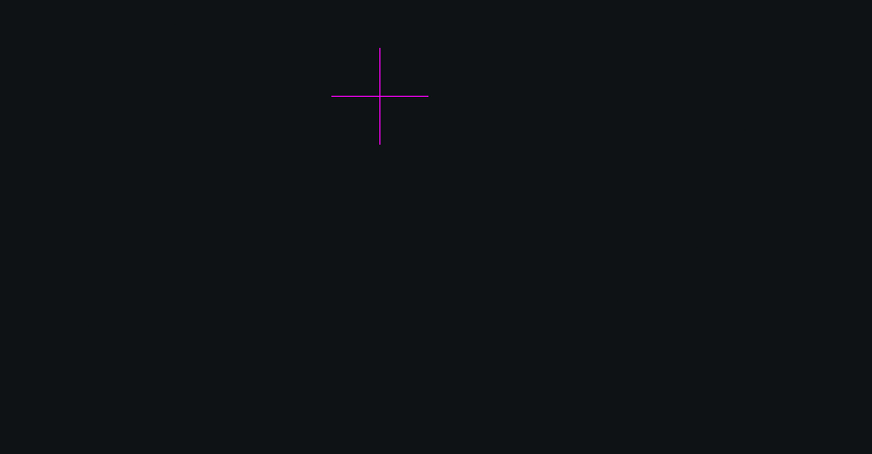

dexus Posted January 28, 2021 Posted January 28, 2021 On 6/12/2012 at 2:36 PM, Lee Mac said: An example, ;; 3-Point grvecs Arc - Lee Mac ;; Example to display a 3-Point Arc using grvecs (defun c:grarc ( / _grarc p1 p2 p3 lst ) (defun _grarc ( sa ea / in pl ) (setq in (/ (rem (+ pi pi (- ea sa)) (+ pi pi)) 25.0)) (repeat 26 (setq pl (cons (polar '(0.0 0.0) sa 1.0) pl) sa (+ sa in) ) ) (apply 'append (mapcar 'list pl (cdr pl))) ) (if (and (setq p1 (getpoint "\nPick 1st Point: ")) (setq p2 (getpoint "\nPick 2nd Point: ")) (setq p1 (trans p1 1 0) p2 (trans p2 1 0) ) ) (while (= 5 (car (setq p3 (grread nil 13 0)))) (redraw) (if (setq lst (LM:3PArc p1 p2 (trans (cadr p3) 1 0))) (grvecs (cons -3 (_grarc (cadr lst) (caddr lst))) (list (list (cadddr lst) 0.0 0.0 (caar lst)) (list 0.0 (cadddr lst) 0.0 (cadar lst)) (list 0.0 0.0 (cadddr lst) 0.0) (list 0.0 0.0 0.0 1.0) ) ) ) ) ) (redraw) (princ) ) ;; 3-Point Arc - Lee Mac ;; Returns the Center, Start/End Angle and Radius of the ;; Arc defined by three supplied points. (defun LM:3PArc ( p1 p2 p3 / cn m1 m2 ) (setq m1 (mid p1 p2) m2 (mid p2 p3) ) (if (setq cn (inters m1 (polar m1 (+ (angle p1 p2) (/ pi 2.)) 1.0) m2 (polar m2 (+ (angle p2 p3) (/ pi 2.)) 1.0) nil ) ) (append (list cn) (if (LM:Clockwise-p p1 p2 p3) (list (angle cn p3) (angle cn p1)) (list (angle cn p1) (angle cn p3)) ) (list (distance cn p1)) ) ) ) ;; Midpoint - Lee Mac ;; Returns the midpoint of two points (defun mid ( a b ) (mapcar (function (lambda ( a b ) (/ (+ a b) 2.0))) a b) ) ;; Clockwise-p - Lee Mac ;; Returns T if p1,p2,p3 are clockwise oriented (defun LM:Clockwise-p ( p1 p2 p3 ) (< (* (- (car p2) (car p1)) (- (cadr p3) (cadr p1))) (* (- (cadr p2) (cadr p1)) (- (car p3) (car p1))) ) ) Some more examples: http://lee-mac.com/3pointarccircle.html I know this is an old thread, but I used the code above for a project of mine and have encountered a problem with it. In one of my drawings the line is rendered in a different place from the cursor. Not sure why this is happening, maybe something to do with the ucs? Here is an example, and below is the drawing in which this happens. Anyone know what is wrong? tan.dwg Quote
dexus Posted January 29, 2021 Posted January 29, 2021 21 hours ago, dexus said: I know this is an old thread, but I used the code above for a project of mine and have encountered a problem with it. In one of my drawings the line is rendered in a different place from the cursor. Not sure why this is happening, maybe something to do with the ucs? Here is an example, and below is the drawing in which this happens. Anyone know what is wrong? tan.dwg 103.65 kB · 1 download I managed to make it work by getting rid of the matrix conversion. Not sure how to do it with the matrix, but this works for now. ;; 3-Point grvecs Arc - Lee Mac ;; Example to display a 3-Point Arc using grvecs (defun c:grarc ( / _grarc p1 p2 p3 lst ) (defun _grarc ( sa ea pt radius / in pl ) (setq in (/ (rem (+ pi pi (- ea sa)) (+ pi pi)) 25.0)) (repeat 26 (setq pl (cons (polar pt sa radius) pl) sa (+ sa in) ) ) (apply 'append (mapcar 'list pl (cdr pl))) ) (if (and (setq p1 (getpoint "\nPick 1st Point: ")) (setq p2 (getpoint "\nPick 2nd Point: ")) (setq p1 (trans p1 1 0) p2 (trans p2 1 0) ) ) (while (= 5 (car (setq p3 (grread nil 13 0)))) (redraw) (if (setq lst (LM:3PArc p1 p2 (trans (cadr p3) 1 0))) (grvecs (cons -3 (_grarc (cadr lst) (caddr lst) (car lst) (cadddr lst)))) ) ) ) (redraw) (princ) ) Quote
