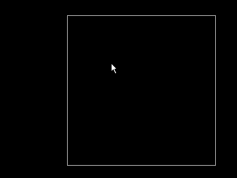

JD Mather Posted June 11, 2012 Posted June 11, 2012 (edited) I'm sure there are many ways, but one way draw horizontal line lenght 22 across part of the rectangle click end grip to make hot right mouse button and rotate 45 or -45 right mouse button grip again and Move to tracked intersection with first line select second endpoint of line and right mouse button Move to second tracked intersection. If you were using a later release you could simply use parameters and change the geometry to whatever you want. Edited June 11, 2012 by JD Mather Quote

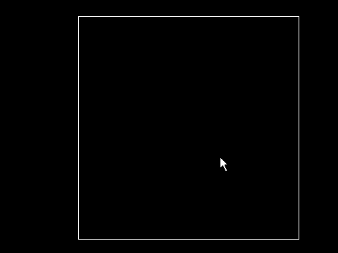

nestly Posted June 11, 2012 Posted June 11, 2012 I would do what JD said, although I since I keep 45degree Polar Tracking and Intersection OSnap running, there are a few less steps. Quote

Blackfish Posted June 12, 2012 Posted June 12, 2012 As you said nestly's solutions is the easiest and the animation clear enough. What is your problem with 'where it needs to sit on the corner'? Follow nestly's gif and it'll be fine. Quote
nestly Posted June 12, 2012 Posted June 12, 2012 The animation I posted above really only varies from JD's description in that I started with the line already at 45 degrees. Here is another one following JD's instructions more closely. Quote
