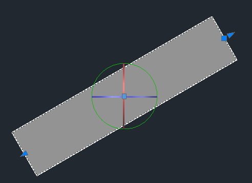

Hi,
How can I rotate the Gizmo in AutoCAD 3D in order to rotate a part as shown in these picture:
I have tried UCS : ZA - Face - View... but i did not succeed :oops:
Thank you :)

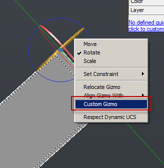

Hi John
Just right click on gizmo and select personalized gizmo
now select orign, x et y axis of edge
By
Pascal

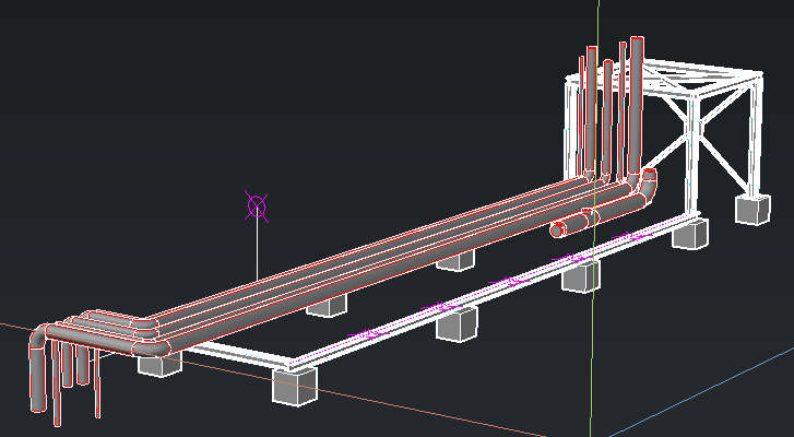

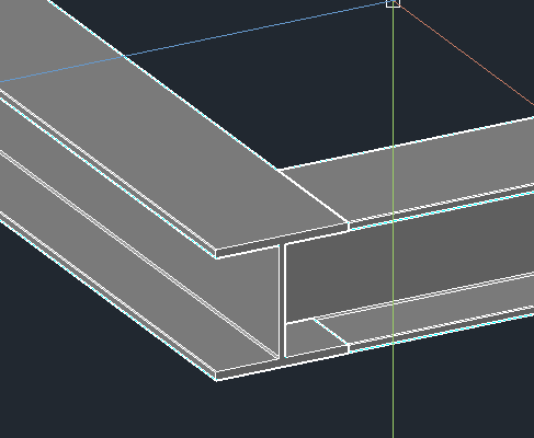

Your beams are overlapping in the corners. Shouldn't at least two of them (opposite sides) be coped?
Is there any tool to cut beams? i have used extrusion and boolean to cut some parts but i have to finish the work.
I know in AutoCAD Plant 3D there is a nice tool to do it but now i'm working with MEP 2011.
I have no knowledge of MEP. I could do it in plain AutoCAD using an extruded polyline and the SLICE command with SURFACE option.

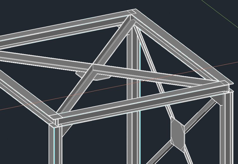

I'm guessing then that your two angles on top has one punching through the other as well and you have them extended in the corners right into the beams too. Is that correct?
Yes correct
I have cleaned up my work a litle bit :)
It's a start. How important are these types of details to what your are actually doing with this drawing? Is steel framing the focus of this drawing?
Yes it important it's a support for Piping.
Is there a tank or another piece of equipment going on that structure?
How were you planning to secure the piping to the structure?
Those piers look exceptionally high. Why is that?

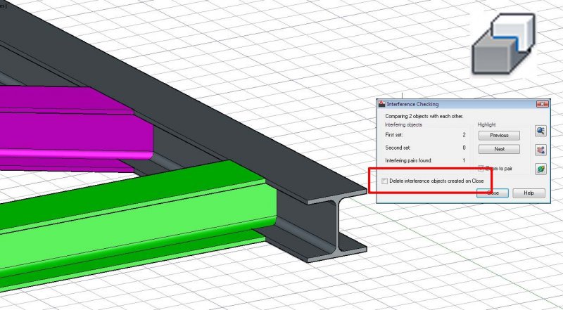

Hi,
You can also use interfere checking for some steel frame intersection
Home Tab/Solid Editing panel/Interference Checking
Dont forget to uncheck delete interference object to keep it to substract after.
