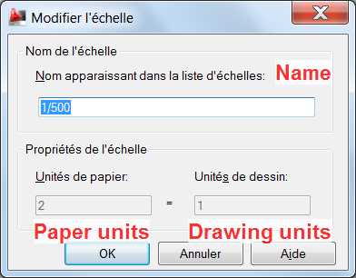

To put a good scale of your drawing, you have to explain at Autocad witch working scale your drawing.
That is how many mm with regard to this scale : (see table in below)
And just set scale factor in properties viewport in paper space or zoom and XP in object floatting space.
By
pascal
To change scale list
an example :
Sorry the dialog box in french

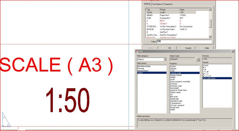

You can create a new FIELD or edit an existing attribute to create a field, by double clicking it, then in the right click menu select INSERT FIELD.
Follow the image attached, and understand that the field will be updated (assuming the default FIELDEVAL setting of 31) automatically when saved, opened, regenerated, plotted or e transmitted. :)
What this won't do is display it as 2, I assume that change could be easily formatted in the Field expression box.
Edited by Dadgad
After a sleepless night I have finally worked it out!!
I just have to add *1000 in the formula.
The formula is:
1/1:5.0000:*1000

Thank you very much, Andrew, for your quick response and the quality of it.
Excellent title block!
The key is to put "1:" in the mtext off the field.
