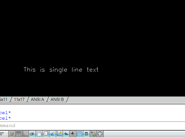

dsibbo Posted June 8, 2012 Posted June 8, 2012 (edited) I need to change the style of my single text, not Mtext, but just text on AutoCAD 2011. If I try to edit Mtext then the Ribbon on the top of Cad changes to Text Editor and allows me to modify the text as I require. However when I click into single text all that happens is the text becomes highlight and I no longer get the option to change the style or font. Can anyone tell me what toolbar or option is missing so I can get it back as normal. Thanks Edited June 8, 2012 by dsibbo Quote

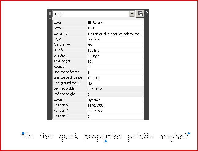

ReMark Posted June 8, 2012 Posted June 8, 2012 Are you referring to the box that comes up that lists the Layer, Contents, Style, Annotative, Justify, Height and Rotation? Quote
dsibbo Posted June 8, 2012 Author Posted June 8, 2012 Yes, that is the box i'm looking for. I have changed PC's and it doesn't appear on this PC when I click single line text. Quote
ReMark Posted June 8, 2012 Posted June 8, 2012 That is the Quick Properties dialog box. You can toggle it On/Off via an icon on the bottom left hand side of your screen. I think it is the second one in from the right. Quote

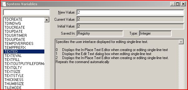

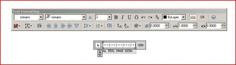

Dadgad Posted June 8, 2012 Posted June 8, 2012 That is the Quick Properties dialog box. You can toggle it On/Off via an icon on the bottom left hand side of your screen. I think it is the second one in from the right. I am a huge fan of QUICK PROPERTIES, but sounds to me like we might be talking about the TEXT FORMATTING TOOLBAR. I think the SYSTEM VARIABLE displayed in the image may sort you out. I suspect you want your TEXTED setting to be 2. Quote

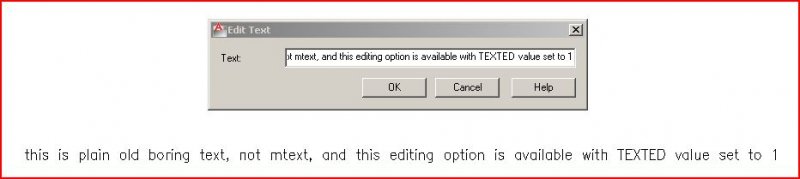

ReMark Posted June 8, 2012 Posted June 8, 2012 TEXTED = 1 will display a dialog box on screen but there are no options associated with it. At least one has options with the Quick Properties window. Quote
dsibbo Posted June 8, 2012 Author Posted June 8, 2012 Dadgad, It appears what you have indicated is what I am looking for. Could you explain how I get this box to appear again please? Thanks Quote

Dadgad Posted June 8, 2012 Posted June 8, 2012 (edited) OK so how do i change the font. I have text that has been drawn on a text style, but the text itself has had its font individually changed, so no matter how many times I change the style, the font still needs changing. This is similar to having a layer which is coloured blue, yet all objects on that layer changed to yellow, no matter how many times i change its layer, everything will remain yellow until i change it to back by layer. Quick properties isn't the window i'm looking for. You sound like you need to change the TEXT to MTEXT. The text formatting toolbar which I posted earlier is for editing MTEXT. In new versions there is an EXPRESS TOOL, the TXT2MTXT command which could quite easily be used to convert all of those annoying TEXT bits into MTEXT. Having done that you would get back the TEXT FORMATTING EDITOR you want by double clicking on any MTEXT. If you set you TEXTED value to 1 you will get the minimalist editing display shown in the image. Edited June 8, 2012 by Dadgad Quote
