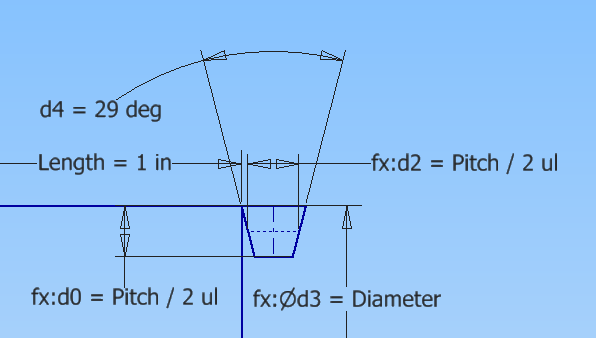

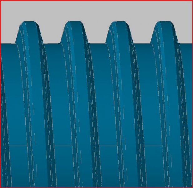

You should go to the library and pick up a reference book or search the internet and find a reference for ACME thread dimensions.
Once you have real information on the dimensions I can help you model this thread.
An ACME thread has a 29° included angle to the teeth.
The profile of the tooth will be created and then the Coil command used to cut it from shaft.
I've done it with Autocad, but it was quite tedious and a challenge coaxing it to sweep the helix. :)

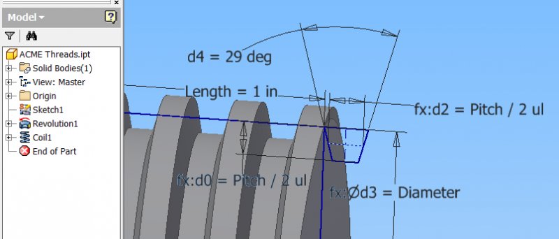

You will have to attach a file here if you are having trouble.
I did a simple Revolve of a rectangle for the rod
and a Coil to cut the thread.
Just like turning the diameter on a lathe and cutting the thread on a lathe.

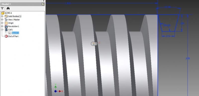

managed to do it, think i worked the dimensions out right, i couldnt do it by using formula's like it looked like you did i just worked the dimensions out and entered them in
more learning needed on my part :)
anyway thanks for your help
heres the file, i understand the will be better and easier ways to do it but i dont know how yet
