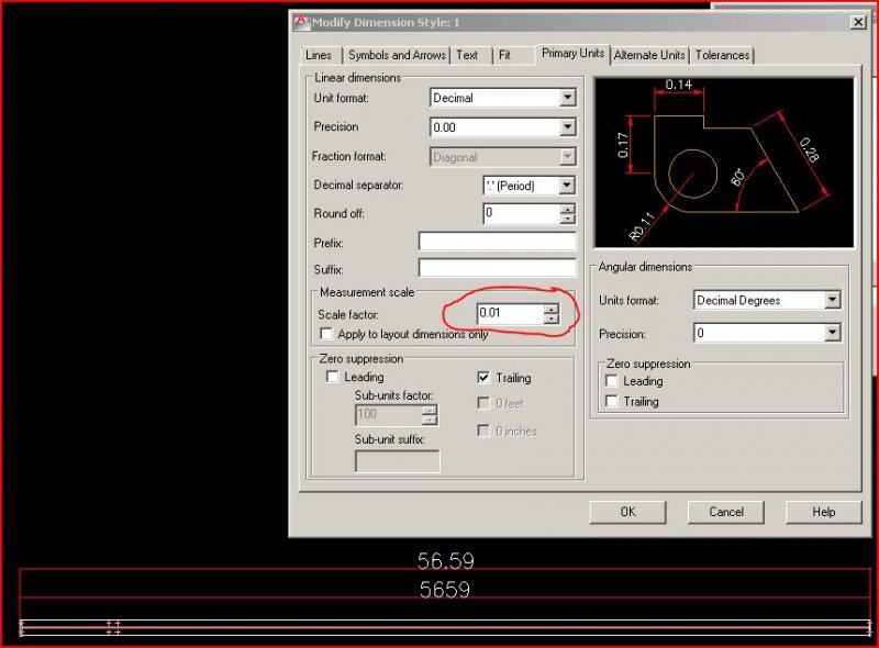

Hi, I have completed a drawing and not used the correct dimension. Instead of using 15.50m I have drawn 1550 so 100 times bigger. The problem not realised until I am putting on paper and the scale is obviously not correct. Is there a quick fix were I can highlight the complete drawings in model and reduce to the correct 1.1?

Ctrl+A > SCALE > scalefactor 1/1000 perhaps? Or if you don't want to change the drawing you can change the dimscale on the dimension style tou are using

Do as Tiger suggested, just check her math (see my note after her quote).
Tiger, I think you probably meant 1/100 or .01 eh?
Speed typing perhaps?

My guess is that if you enter UNITS at your commandline you will discover that your drawing units are set to meters, and you wanted them to be set to centimeters, whence the source of your problem. :)
Just scale it down as previously suggested by .01, and next time you start a drawing set your units before you start drawing.

Yeah looks like you are right nestly, perhaps the OP's problem is not actually the scale at which it was drawn....
RIGHT the dimension is displaying millimeters, not meters.
1550 which is being displayed is the length in mms, and Dave is taking that to mean meters!
Dave try switching your dimension units to ARCHITECTURAL temporarily and create a new dimension in IMPERIAL units, so we can determine which is your issue. :)

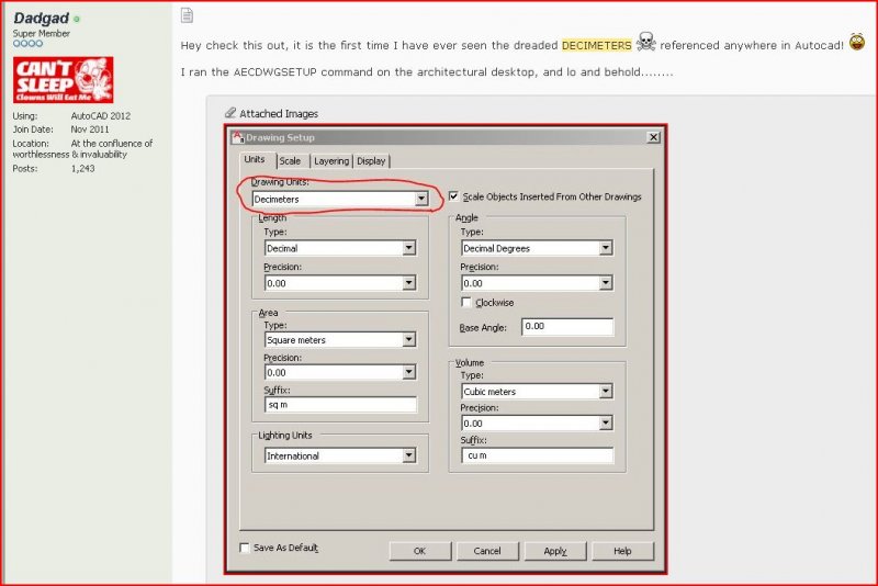

This reminds me of a recent thread, except that it was on the architectural desktop (this does not seem to be), where the units specified were somewhat unorthodox, decimeters, in my opinion.

I think it's easier than that. Simply dimension a line, then check the line's properties. If they're both 1550, then the drawing should be scaled down so the line is actually 15.50 If the dimension is 1550, and the properties palette says 15.50, then the dimension scale needs to be adjusted.
In the end however, I don't think it matters whether a metric drawing is scaled down, or the dimstyle is scaled up. I can imagine that some users may intentionally enter Centimeters or Millimeters, even in a drawing where 1 unit = 1 meter, just to avoid keying in all those decimal points.
Should the factor indeed be 100 then the dimension display can be adjusted as shown in the image, so that it will display accordingly.
Personally I always leave this at 1, just saying if needed there is a way. :)
