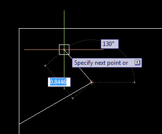

What size of crosshair do you use in AutoCAD (system variable: CURSORSIZE)?

I still use 100% ... probably just because I'm used to it, though it does help to check if stuff are aligning (though you could go and "draw" a temporary line for that). I don't know about too many lines on the DWG ... for me a line that stops somewhere on the screen means it's a line of the drawing itself, one that goes to the edge of the screen is usually the cursor. :unsure: I think shorter cursor lines confuse me, but that's probably just my "confused" mind I guess.
About the snapping, I constantly have End/Mid/Int/Node/Ins/Cen turned on. For Perp/Near/Quad/None I use Shift-RightClick or my own keyboard shortcuts on the numpad, though that one's gone out of fashion since the new polyline editing which gets interference with Ctrl and so. I do however turn on the Aperture Box so I can see where the snap is going to happen, immediately ... waiting for that popup to say that it's going to snap to the endpoint is plain time wastage.

. . . . I do however turn on the Aperture Box so I can see where the snap is going to happen, immediately ...
Same here. And at a fairly large 12 pixel target height.
Perhaps that would be another interesting poll: What is your APERTURE variable setting?
Actually if you go that route, then you should include something like: Aperture On/Off/Size2-20/"What the Hell is This :shock:"
I think due to ADesk turning it off by default (APBOX=0) most newer Cadders don't even know that such exists.
BTW, due to a "very" old addon I used in the DOS days I have my Aperture=5 and my PickBox=3. The addon was a one-click fillet command, where it displayed both the apperture & pickbox at once and if you clicked on an intersection the 2 lines would be filleted along their longest portions from the intersection. And with the settings this way the double-PickBox looked & worked the best, now I'm just stuck to being used to those sizes. Fortunately my eyes are still reasonably good, so I can keep on using this finer-grained boxes.
I don't understand why the proximity setting for Pickbox and Aperture should be different. I use 6 for both.
