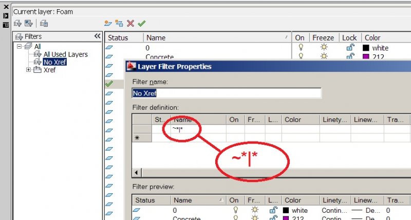

For several releases Autocad's layer manager has shown only XREF layers in the layer manager by default. Open a drawing with Xrefs (nearly every drawing I have ever worked with) and to access the layers that are actually *in* the drawing, I must first open the layer manager, select the "Xref" filter, and check the Invert Filter box. Then I see the layers that would more logically be shown be default.
Does anyone know a way to change this so the non-Xref layers show up be default??? I am currently using Autocad Architecture 2012.

It sounds like you're saving the drawing with an inverted filter applied, but AutoCAD doesn't have a setting to "remember" the invert setting from session to session, so the drawing(s) is opening with the filter applied, but not inverted.
You should add a filter that doesn't need to be inverted to hide the layers you don't want to see.... (or disable the inverted filter before closing). The easiest and most common method is to create a No Xref filter that shows only layers that does not contain (~) a pipe (|) since that symbol is common in all xref layer names.

Yes, that's what has been happening! Since I almost never start with a new drawing, the XREF filter is always there. I'll start using this layer filter, it works like a charm. Thanks! I stopped learning new tricks around acad2004 but due to a recent switch to 2012 I am on an all new learning curve. Great to have one sticky issue resolved.
