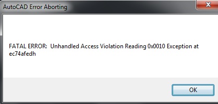

Does someone know why I get this FATAL ERROR when I open my Autocad file? It's gonna close the Autocad window!!!

We are talking one particular drawing are we not?
A quick check of the AutoDesk website drew a blank when searched on the basis of the entire error message. There were, however, quite a few hits on the words "reading 0x0010".

The only different things I can find in this drawing file are two pictures Inserted and 3D texts!
Have you tried to run a RECOVER on this drawing?
Not really! How can I do this?
Open a new drawing. Then use the RECOVER command to bring in the drawing that is giving you problems. Follow the command line prompts.
I did! I can work with my file now. However, my pics don't appear anymore!
