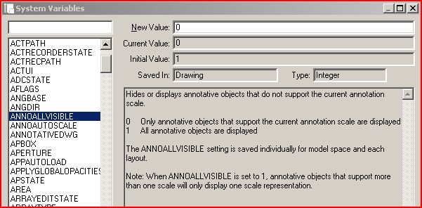

Check your ANNOALLVISIBLE variable setting? :)
