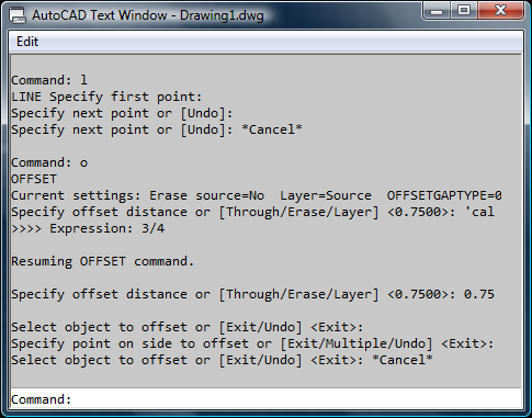

Hit F2
Post screen shot of your steps (from F2).
Hit F2

F2 and then hit Alt Print Screen and then open MSPaint and Ctrl V , now tell me, what is copyrighted in that screen shot that you can't show?
(you should have a simple list of your command line entries to reproduce the problem, no geometry at all)

I didn't even bother to try to reproduce your steps - I want to absolutely know what you did, F2 will tell me that.
Go back to the 'cal step, type your expression, now swipe your cursor over the area where you expect text. I am wondering if the text is set to a color that won't show in that window.
As you are typing more and more into the little 'cal window it should grow in size, does it do that?

Thanks for the suggestion of "swiping your cursor" I typed "L" clicked and dragged away from the quadrant in question, then went to the command line moved the mouse and typed the expression, and it worked.
I don't know why the dynamic prompt didn't show up on screen...
