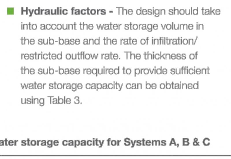

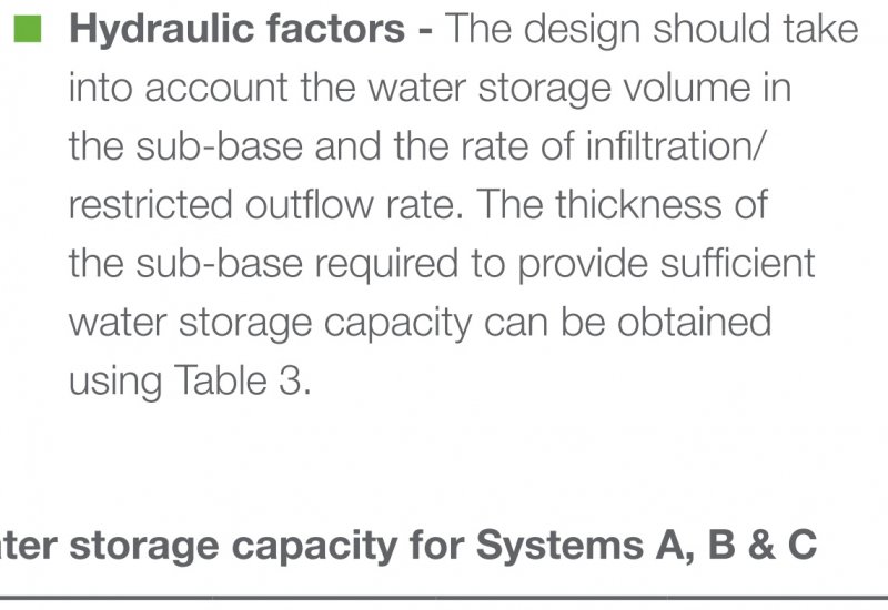

On a set of drawings I am doing I have underlaid a selection of A4 PDF files in my A1 drawing. Everything looks perfect in model & paper space while in AutoCAD. As soon as I publish to PDF using AutoCAD the New PDF does not display the same quality as the original PDF's or as it is shown in model or paper space.
Does anyone know how to resolve this?
I will try and attached screen shots below.

If I understand your situation, you're adding a PDF underlay to a drawing and then plotting that same drawing to PDF. In effect, you're translating the PDF material from one format to another and then translating it back. That's what's causing the poor quality.
The obvious solution is to plot the drawing without the PDF material and then combine it with the existing PDF. You may have trouble aligning the two PDFs, but if it's text as in your example, you shouldn't have any trouble.
