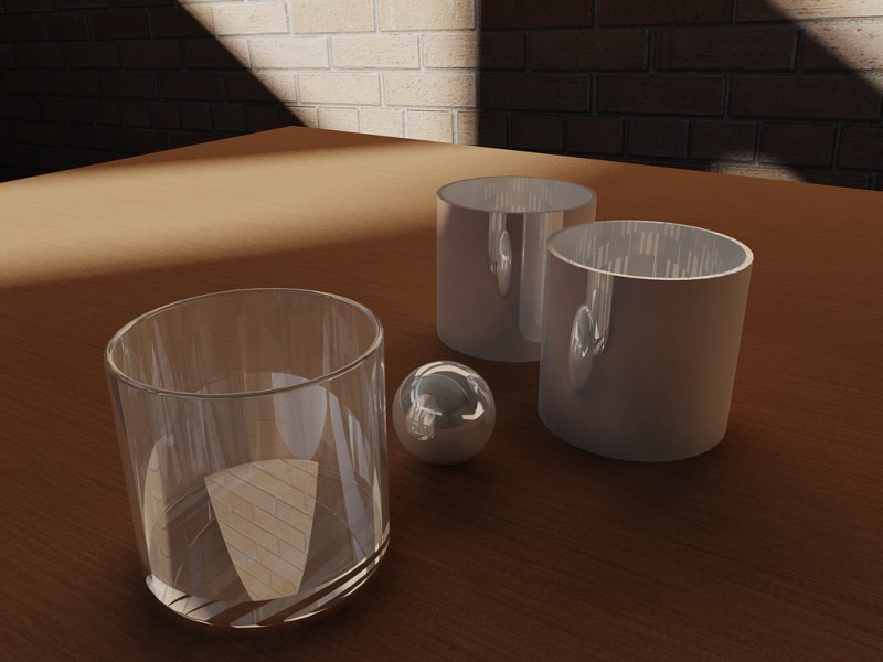

SEANT Posted June 2, 2012 Posted June 2, 2012 Try scaling the model. Currently, the table is 0.7800 millimeters tall. I scaled everything 40X to get the render below. Quote

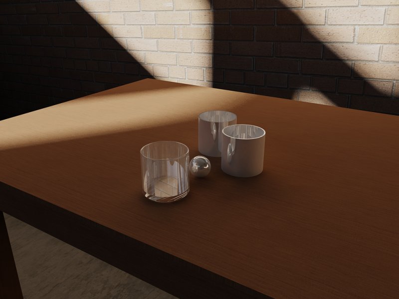

FernandoLucchesi Posted June 3, 2012 Author Posted June 3, 2012 Thanks SEANT! That got the job done, I scaled everything up to 100x and it's rendering PERFECTLY! I would also like to thank everyone of you guys (ReMark, StykFacE, JD Mather and Cad64) who had spent your time here trying to help me, and even if it didn't helped me directly on this project, you can all be sure that you all taught me alot of things that I'll probably use sooner or later, so, thank you all very much! It took me some time to reply because i wanted to render it, so i could share with you guys what you've helped me to accomplish, here are the results: Quote
