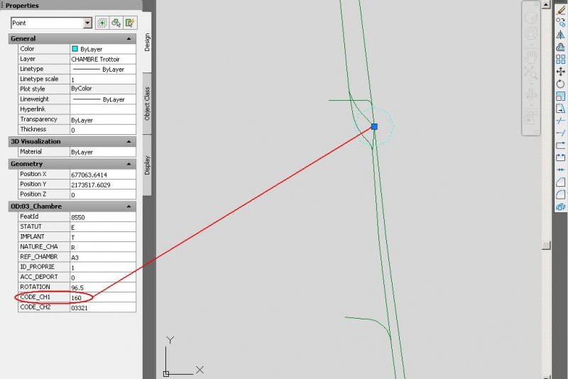

We received some new plan from our client.
and this time, polylines are not "connected" to block, but to point with CODE_CH1 attribute.
03-PIT2.dwgFetching info...
could you modify your routine to obtain the length for each polyline.
there are several layer and it's important to keep the length separated
(for example: caniveau = gutter ; enterre = buried; ...)
it's not the same team who will make the construction
thank you

All you need is the length and no indication as what is connected to what block? that will loads easier. what will be the final table will look this time?
the aim is to complete the same final table.
so I need
CODE_CH1 of start point / CODE_CH1 of end point / length between start point and end point.
And if there is no start or end point, juste an indication like NULL
Since theres no attribute to identify the block as you had before then you'll have a problem there. Since this time you are using points the only way to identiy what goes whre is the coordinates (as per your original request. (i think i trashed that code for that sometime ago)
Besides, Hlalf of them are not even polylines
Again there are overlapping lines
It is still doable that much i can tell you :)
BTW what is CODE_CH1 again?
EDIT: Here's what we can do. we would write a supplemental routine to give the POINT entiteis an "identifier" might it be a attribute or Xdata. but the problem there would be what values go to what point entity and where?
Think about it for now. and let me know if you have an idea how to go about assinging the values or identify the points besides the coordiantes.

  guigol said:
I think there is an attribute CODE_CH1 for each point, no?
Strange. it doesnt show here in ACAD 2009
  guigol said:
sorry, i didn't understood this part.
Well of course it wont make sense to you guigol, You're seeing the attributes and i dont. :)
Maybe i can help you if i'm a using a newer version of cad or MAP. I'm running blind on this one.
