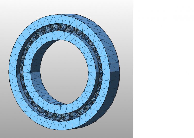

dusko Posted June 24, 2012 Posted June 24, 2012 hello! i have a problem with exporting stl. some of solids are missing and i'm not sure why, because they are same solid copied number of times. original solid was made with open polyline and revolved (360) and it looks like pin. there is a dwg in attachment (i can't attach stl, but some of those pins beneath balls are missing). thank you! lezaj_3d.dwgFetching info... Quote
SEANT Posted June 24, 2012 Posted June 24, 2012 tonka said: Of course, thank You for helping! http://dl.dropbox.com/u/75885202/puno%20tocaka_slojnice.dwg Sorry, I lost track of this post. Here is the best I could do. I had to bring the geometry closer to WCS origin to process. The replacement may be a bit off. http://dl.dropbox.com/u/28623452/puno%20tocaka_slojnice.zip Quote
SEANT Posted June 25, 2012 Posted June 25, 2012 dusko said: hello! i have a problem with exporting stl. some of solids are missing and i'm not sure why, because they are same solid copied number of times. original solid was made with open polyline and revolved (360) and it looks like pin. there is a dwg in attachment (i can't attach stl, but some of those pins beneath balls are missing). thank you! I only have AutoCAD 2012 to test, and it seemed to convert the model to STL well enough. Here is what came of the process: http://dl.dropbox.com/u/28623452/lezaj_3d.zip Quote
dusko Posted June 25, 2012 Posted June 25, 2012 thank you seant! yes, your stl is fine. i have 2010 and i try to export separately just one ball and one pin and same problem occur, pin is missing. now either ac 2010 is having a problem with revolved open polyline or i have a problem with setting and exporting stl (but 3DPRINT command is pretty easy to use). Quote
JD Mather Posted June 25, 2012 Posted June 25, 2012 dusko said: now either ac 2010 is having a problem with revolved open polyline or i have a problem with setting and exporting stl Revolve of an open polyline is not a solid. Stlout works on solids. Quote
dusko Posted June 25, 2012 Posted June 25, 2012 (edited) now i see in help that revolved open polyline is a surface and closed is solid (i try that and it works). properties show revolved open polyline as 3d solid so i believed in this info. another question that i have is why some other pins are exported in stl (as i said before, they are copies from origin) or why seant could export file (without errors) in one piece with 2012? thank you very much for answers. Edited June 25, 2012 by dusko Quote
