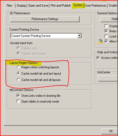

Dana W Posted September 16, 2013 Posted September 16, 2013 Jokes aside, ok tried this but didnt auto regen as I zoomed in still zagged lines on a circle and had to manual regen. What do these commands do? Edit: there both default settings. Regenmode set to 1 will get you a regen within certain commands, such as draworder. If set to 0, the draworder will not change on the display until a regen command is executed. I don't have a regenauto in LT, but I remember in full version 2007, there was apparently a variable that if set the right way would execute a regen when changing spaces or layouts. Can't remember it. 2007 was new at the time I used it for an employer. I do remember that we had it turned off, because the regen would make it take several wasted seconds to change layouts in some larger drawings. Quote

Dadgad Posted September 18, 2013 Posted September 18, 2013 Regenmode set to 1 will get you a regen within certain commands, such as draworder. If set to 0, the draworder will not change on the display until a regen command is executed. I don't have a regenauto in LT, but I remember in full version 2007, there was apparently a variable that if set the right way would execute a regen when changing spaces or layouts. Can't remember it. 2007 was new at the time I used it for an employer. I do remember that we had it turned off, because the regen would make it take several wasted seconds to change layouts in some larger drawings. You can set this on the SYSTEM tab in OPTIONS, there is no named System Variable for it. Quote
