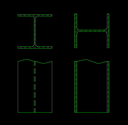

ReMark Posted May 23, 2012 Share Posted May 23, 2012 (edited) Welcome to the CADTutor forum Rock and thank you for your kind words on behalf of everyone who has contributed in one way or another to a Penn-Foster thread. I could only take a real quick look but I have a couple of comments. 1. It appears that some vertical rebar is missing in each pier/footing. 2. The siding runs vertically not horizontally (if I recall correctly). 3. It appears that the floor decking is missing. Cannot pour all that nice concrete you are showing without decking on top of the beams otherwise somebody is going to have a big mess on their hands. 4. Depending on which way a "W" shape column/beam is viewed the resultant depiction of it will be different. Looking at the flat face of the flange the web would be dashed. Looking at the same column/beam from a different side one would see the top/bottom edges of both flanges. Understand? If I get a chance later I'll take a more in-depth look. Edited May 23, 2012 by ReMark Quote Link to comment Share on other sites More sharing options...
ReMark Posted May 23, 2012 Share Posted May 23, 2012 This is what I was talking about in item number 4 above. It is two views of a W10x39. On the left we are looking at the flat face of the flange (the web is hidden so it is dashed). On the right we are looking at the edges of the flange. Hope this helps. Quote Link to comment Share on other sites More sharing options...

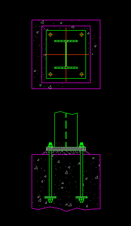

ReMark Posted May 25, 2012 Share Posted May 25, 2012 An example of a baseplate that uses four bolts. Notice that the column sits on top of the baseplate. Quote Link to comment Share on other sites More sharing options...
ReMark Posted May 25, 2012 Share Posted May 25, 2012 This baseplate uses only two bolts. Notice once again the column sits on top of the baseplate. It is so much easier for the fabrication shop to weld the baseplate to the column this way. If the bottom of the baseplate and the column were the same the baseplate would have to be made in two pieces that were "coped" to fit between the flanges. Too much work would be involved to make this a cost efficient method. Quote Link to comment Share on other sites More sharing options...

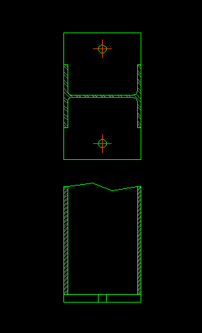

Rocktamusprime Posted May 25, 2012 Author Share Posted May 25, 2012 Thank you for all the advice, i have a lot to go over on this drawing. Tell me the process by which you created the metal floor decking. It doesn't appear to be an efficient method. It looks like you used individual lines and filled the space between with a solid hatch but you did this for only a small section of the decking then copied it. Am I correct? 100% correct, i'll add that to this list of things to change this weekend. I just got a copy of 2013 to use at home, since the student version (school supplied) would not run on any of my desktops or laptops at home and i've been, until this point, restricted to doing these while at work. Re: bottom of your columns. It appears your baseplate is between the flanges of the column. In some cases this may be one method used but do your instructions indicate the size of the baseplate and its position relative to the column itself? I kind of expect, in the view you have drawn, for the baseplate to extend in either direction some small distance beyond the face of flange. Upon closer inspection of your baseplate it appears to be extending into your flanges. Now that would be entirely wrong. The column usually sits on top of the baseplate. The dimension given is, "The plate is 14 x 14 x 1/2. The W12 x 152 steel column is welded to the plate" Thank you for the examples, i'll raise the columns to sit upon the plate. I will also get more familiar with the BLOCK and WBLOCK functions, i use them for my piping drawings and for some reason (insanity at work and a general lack of logical brain processing resulting from said work insanity), never thought to carry it over to this application. Again, thank you very much for all the insight and time you have given. Revision 2 here i come! Quote Link to comment Share on other sites More sharing options...

Rocktamusprime Posted May 25, 2012 Author Share Posted May 25, 2012 (edited) Nope, i've uploaded my instruction book. Pg 12. May have been one of the changes made to the program. 054040.pdf And now see that my columns are too wide, plate will be same size and columns to sit on top. Edited May 25, 2012 by Rocktamusprime omission Quote Link to comment Share on other sites More sharing options...
