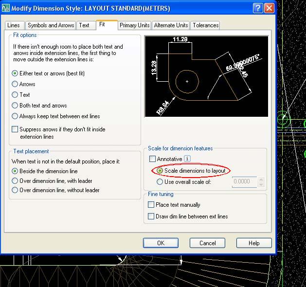

one way is to use annotative dimensioning, this way you dont have to create multiple dim styles with different text heights, arrow head sizes etc.
Another is to directly dimension in paper space but you must set your dim style to "scale dimensions to layout", then if need be that the dimensions are to be in model space, use CHSPACE command to switch the dimensions from PS to MS.
Here's where you change dims to "scale dims to layout"

Your illustration helped me fix the problem perfectly, thankyou.:)
