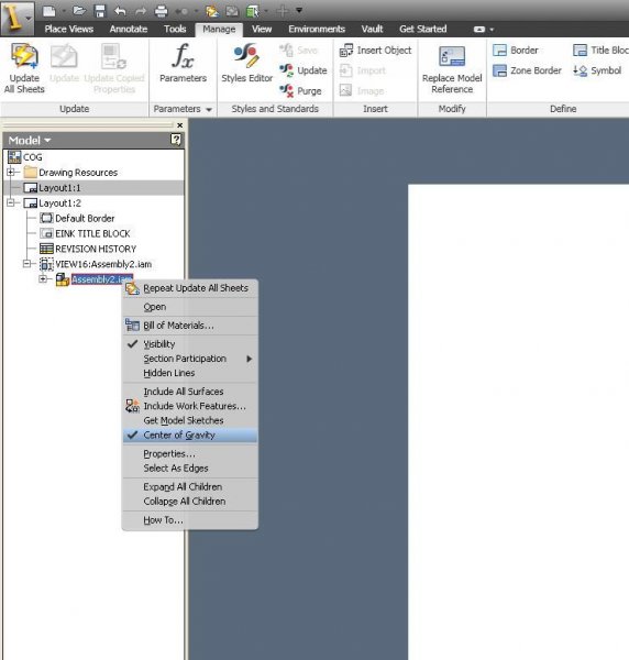

Is it possible to place the Center of Gravity XYZ point into my drawing sheet?
You can but you do have to have Inventor 2009 or later to do this.
They took that function away in the more recent versions?
FYI - this is where you can find the center of gravity mark in Inventer.idw sheets
