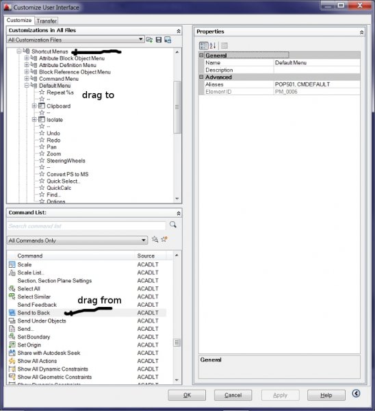

Dadgad Posted May 22, 2012 Share Posted May 22, 2012 i try repair and reinstall, the issue still persist...but if i log in to other profile, the " draw order" working okay...anybody have this issue? This is confusing me, I think you might mean when you switched to another WORKSPACE? How are you saying that you logged onto this other profile, if your PROFILES tab has gone missing? Quote Link to comment Share on other sites More sharing options...
nestly Posted May 22, 2012 Share Posted May 22, 2012 There are no "Profiles" in LT... never have been as far as I know. The missing Draw Order items may be a result of a migration glitch. Did you migrate your settings? If the Draw Order options were ever there, you may try restoring the previous version of the CUI, otherwise you can "reset" the CUI to the default 2013 Out-of-the-box CUI If you have a customized CUI and don't want to reset to the default, then just try adding those items back manually. Bring to Front Send to Back Bring Above Objects Send Under Objects Quote Link to comment Share on other sites More sharing options...

pyerats101 Posted May 23, 2012 Author Share Posted May 23, 2012 but there is no profile tab so how should i do like DADGAD do? Quote Link to comment Share on other sites More sharing options...
Glen1980 Posted May 23, 2012 Share Posted May 23, 2012 pyerats101, you can't do it like DADGAD showed as that is on FULL AutoCAD and you have LT. Have you tried typing the commands in to make sure they still work? If they still work go back to Nestlys comment #22 and manually edit your CUI. If you haven't done this before click on the workspace icon (the grey cog) and select customize. Then it is a case of drag and dropping the commands from the bottom left section of that screen to the top left screen into the shortcut menu section. My screen shot is a little different to yours as I have 2011LT. Also I'm not good with GIMP! Quote Link to comment Share on other sites More sharing options...

pyerats101 Posted May 24, 2012 Author Share Posted May 24, 2012 what i meant by another profile is i log on to another windows user profile and the " draw order " are okay Quote Link to comment Share on other sites More sharing options...
pyerats101 Posted June 12, 2012 Author Share Posted June 12, 2012 done after reformatting windows and install back the autocad...thanks all for the help Quote Link to comment Share on other sites More sharing options...
