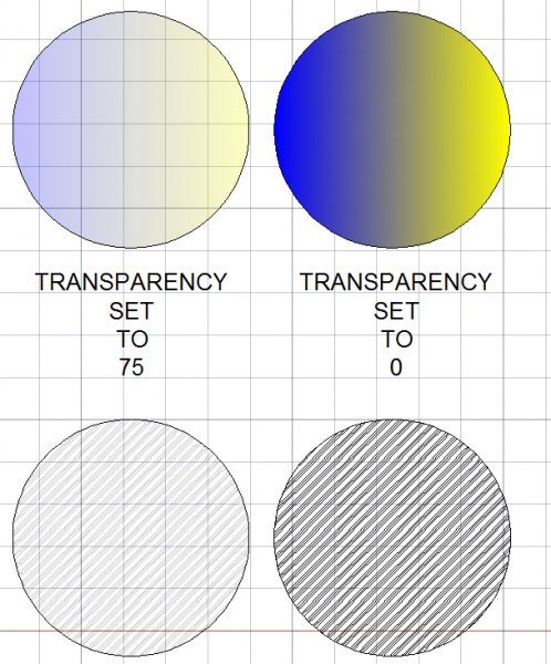

What exactly does the Transparency control do in the Hatch and Gradient mode?
Can someone show me an example?
Thank you.
It allows you to set the transparency level of the hatch object when the transparency "TPY" button is activated on the status bar.

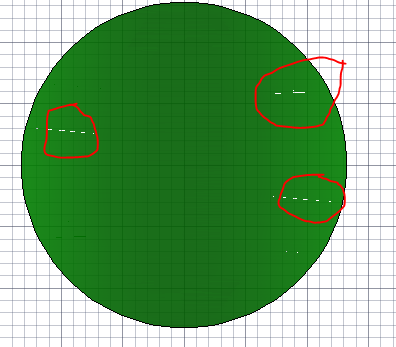

Second, any idea what cuased those white lines ( streaks) in the transparent circle?

I think it a display issue. I see the streaks on my screen. It plots just fine.

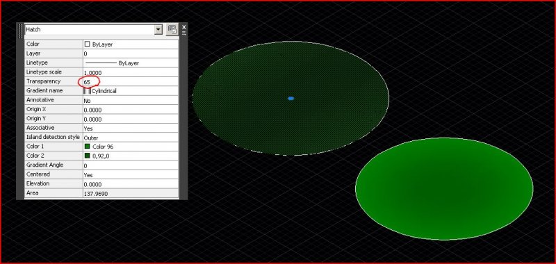

Did you set your TRANSPARENCYDISPLAY system variable to 1?
The circle in the image on the right has transparency set to 0 (meaning it is opaque), the one on the left is set to 65.

I think the steaks he is talking about is in the gradients not the circles.whitestreaks.PNG
I think the steaks he is talking about is in the gradients not the circles.[ATTACH=CONFIG]34908[/ATTACH]
I heartily concur with your assessment, just a display glitch, and of no consequence in the grand scale of things.

More lessons to learn. When I reduce transparencies, I should have the systems variables to 1.
Where do I find this on ACLT 2012?
Thank you all again for the lesson.
....and i still can not capture the screen like you all do..... any suggestions on that issue??? It would make my asking these silly questions a lot easier.
Yes. How? Just type in command line: TRANSPARENCYDISPLAY, press 'Enter/Return' and than 1, 'Enter/Return'. Done.
