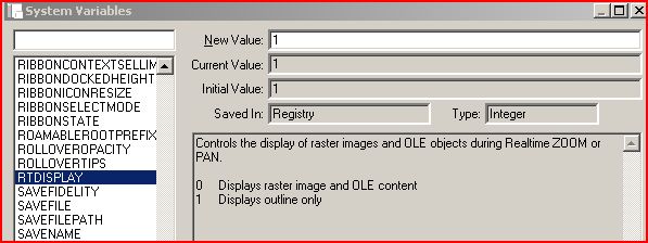

Dadgad Posted May 19, 2012 Posted May 19, 2012 Welcome to Cad Tutor. I believe you want to consider this setting. RTDISPLAY > 0 Enter RTDISPLAY at the commandline and then change the value to 0. Quote
luppolo Posted May 19, 2012 Author Posted May 19, 2012 Many Thanks. But it's not working in autocad 2012 (Autocad Map)..Both values allow to display the frame only! It seems to me this is reffered only to Realtime ZOOM and PAN..I need to see the image shile I'm moving it from a point to another.. Quote

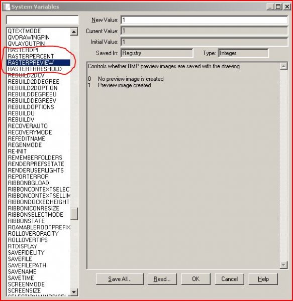

Dadgad Posted May 19, 2012 Posted May 19, 2012 luppolo said: Many Thanks.But it's not working in autocad 2012 (Autocad Map)..Both values allow to display the frame only! It seems to me this is reffered only to Realtime ZOOM and PAN..I need to see the image shile I'm moving it from a point to another.. Sorry that didn't help you. Here are all of the system variables which begin with RASTER, I looked at them, and don't believe that they will help you either. Quote
luppolo Posted May 19, 2012 Author Posted May 19, 2012 Yes..I agree.. Thanks in any case.. I believe this option was avalible in older autocad versions...(but not so sure..!) Quote
