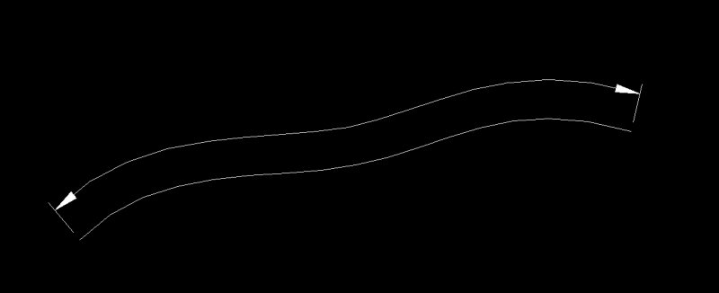

Hi
Is there and routines that would put a dimension along a curvy line? I dont need the actual dimension on, just the lines following the curve with the arrows and the perp lines coming out at each end. Its just to show extents along a curved road, and then a note next to it. I can do this manually by offsetting the line, and manually put the arrows and lines in at each end, but that is so time consuming when you have a lot of these to do.
Thanks
Martin
Had a few minutes and was feeling generous:
[color=GREEN];; Dimension Curve  -  Lee Mac 2012[/color]

I'm guessing somebody's about to be a very happy camper! :) :beer:
WOW, you are the MAN!!!! Thanks so much for this :)
Just wondering, how do I change the size of the arrow heads?
Cheers guys :beer:
I've set the size to be dependent on the size of the arrows in your Dimension Style, specifically the DIMASZ System Variable.
Ok, brilliant, thanks for the lisp. I look at these lisps and just admire how clever you guys must be if you can write these. Looks so complicated :P
Thank you for your compliments bigmaz, I've had a lot of practice :)

Brilliant.
But the measurement text not shown.
Here is one from my oldies, give that a try

@LEEMAC...
Thank you for your "dimcurve" lsp.. if its not too much to ask. can you also add measurement text to you lisp. Thank you

asos2000 said:
Brilliant.
jtiwari91 said:
@LEEMAC...
Please try the following modification:

                   (_arrow
                       (vlax-curve-getstartpoint el)
                       (polar (vlax-curve-getstartpoint el)
                           (angle '(0.0 0.0 0.0) (vlax-curve-getfirstderiv el (vlax-curve-getstartparam el)))
                           (getvar 'dimasz)
                   (_arrow
                       (vlax-curve-getendpoint el)
                       (polar (vlax-curve-getendpoint el)
                           (+ pi (angle '(0.0 0.0 0.0) (vlax-curve-getfirstderiv el (vlax-curve-getendparam el))))
                           (getvar 'dimasz)
                   (setq a (vlax-curve-getpointatdist el (/ (vlax-curve-getdistatparam el (vlax-curve-getendparam el)) 2.0))
                         b (angle '(0.0 0.0) (vlax-curve-getfirstderiv el (vlax-curve-getparamatpoint el a)))
                         p (polar a (+ b (/ pi 2.0)) (getvar 'dimtxt))
                         q (polar a (- b (/ pi 2.0)) (getvar 'dimtxt))
                   (if (< (distance p (vlax-curve-getclosestpointto en p))
                          (distance q (vlax-curve-getclosestpointto en q))
                       (setq p q)
                   (entmake
                       (list
                          '(000 . "TEXT")
                           (cons 10 p)
                           (cons 11 p)
                           (cons 40 (getvar 'dimtxt))
                           (cons 01 (rtos (vlax-curve-getdistatparam en (vlax-curve-getendparam en))))
                           (cons 50 (LM:readable b))
                          '(072 . 1)
                          '(073 . 2)
;; Readable  -  Lee Mac
;; Returns an angle corrected for text readability.
(defun LM:readable ( a )
   (   (lambda ( a )
           (if (< a 0.0)
               (LM:readable a)
               (if (and (< (* pi 0.5) a) (<= a (* pi 1.5)))
                   (LM:readable (+ a pi))
                   a
       (rem (+ a pi pi) (+ pi pi))
(vl-load-com) (princ)
Edited by Lee Mac
