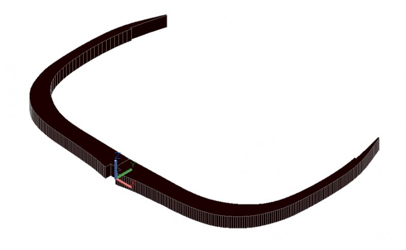

Yorel Posted May 15, 2012 Author Share Posted May 15, 2012 I figured out how to change the scale when the jpg is inserted, but had to insert mutiple times adjusting the factor each time until I got the overall length to within a half inch of the scale drawing (which will suffice for this drawing). My goal is to loft 2 frames (The Ship's frames) in 3D, and try a CNC machine. Quote Link to comment Share on other sites More sharing options...

Yorel Posted May 18, 2012 Author Share Posted May 18, 2012 I finally got the 2D drawing completed, switched to 3D, Still working my way around orientation of the drawing. Can't figure out how to make a notch 1/2 the width (1/8") by 3/4" down from the top in the side view. I can't figure out how to post the DWG of my frame. Quote Link to comment Share on other sites More sharing options...

ReMark Posted May 18, 2012 Share Posted May 18, 2012 Why are you doing this using surfaces instead of solids? Think about it. You aren't putting a skin on the boat like laying a piece of sheet metal over a frame. You are working with solid wooden members are you not? Jeez.....splines. I hate splines. How can the notch be 1/8" deep? I don't think that is right. Boy, you have a lot of little tiny pieces of lines hiding everywhere. I should have run OVERKILL on this drawing before trying to work with it. Quote Link to comment Share on other sites More sharing options...
Yorel Posted May 18, 2012 Author Share Posted May 18, 2012 How do I change it to solids? I'm using splines, because another tutorial using Autocad 2002 showed it being done this way. Is there another way? Quote Link to comment Share on other sites More sharing options...
ReMark Posted May 18, 2012 Share Posted May 18, 2012 Well to create your notch, while still using splines and utilizing surfaces, you'd have to go back to your 2D geometry I think then extrude again. Quote Link to comment Share on other sites More sharing options...

ReMark Posted May 18, 2012 Share Posted May 18, 2012 Starting with AutoCAD 2010, I believe, one could use the SPLINEDIT command to convert a spline into a polyline. If that does not work for some reason you can always try the FLATTEN command and say "No" to deleting hidden lines. I sort of took this approach and when done I created a REGION and then used the PRESSPULL command to give it a height of .25 (seems tiny, you must be doing this for a scale model?). Quote Link to comment Share on other sites More sharing options...
Yorel Posted May 18, 2012 Author Share Posted May 18, 2012 I'm back to my 2D view. I don't know if my lines are joined or not. When I click on one of the splines, it is selected, but nothing else. I thought I had to have a continuous line around the whole drawing. Quote Link to comment Share on other sites More sharing options...
ReMark Posted May 18, 2012 Share Posted May 18, 2012 A continuous line to do what? I gave you the method above I used to create a solid. You should be able to do it as well unless you prefer to work with surfaces. Quote Link to comment Share on other sites More sharing options...
Yorel Posted May 19, 2012 Author Share Posted May 19, 2012 Well, I've got it back to a 3D solid now, and it's looking ptetty good. It is for 1/4" scale model of the USS Endeavour. Quote Link to comment Share on other sites More sharing options...

Yorel Posted May 19, 2012 Author Share Posted May 19, 2012 This frame I'm working on now is one of the midship frames, ie the planks set square on the edge of the frame. Next, I'll try one of the fore or aft frames where the frame has to be beveled for the plank to set flush on a bend. Then I'll go back and start from scratch on this one again, etc, etc, etc. Practice, practice, practice. Quote Link to comment Share on other sites More sharing options...
