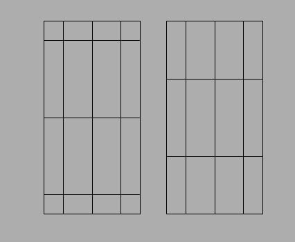

Or you could create a dynamic block, or you could use the new dynamic array. Both of these can be trimmed to the outline of the room using the 'XCLIP' command...

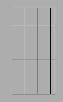

Having re-read the original request (found my glasses), I see the requirement is to start at the bottom left hand corner. Here is an amended picture. Silly me, I always think of equal edge cuts when tiles are mentioned. :?
If it were me, I'd create a hatch pattern based on NET, as Eldon suggested, with the appropriate scale. I'd also set the origin of my hatch at the bottom left corner.
