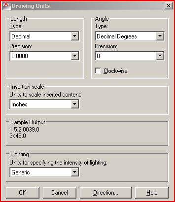

Dadgad Posted May 12, 2012 Posted May 12, 2012 You may want to check your INSERTION SCALE while you are at it. You can also access this variable by typing UNITS at your commandline, which will call up the drawing units dialog box. Quote

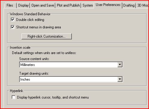

Dadgad Posted May 14, 2012 Posted May 14, 2012 (edited) Remark you said Please explain where I am looking at it wrong kind sir It seems counter intuitive, and yes we should draw and model at 1:1. The program offers metric and Imperial templates, each of which includes scale factors and a dimensional unit bias. I do not understand why it is done this way either, but the software applies whichever scale the template is based upon, to the items or entities drawn or modeled. A straight line might be saved as a vector of length 1000 units. If it is inserted into a drawing of a different dimension type (metric versus imperial) then a scaling factor needs to be applied at that time. Look at post # 9 and you will see that your target scale will be the units in which you are working. If the units (metric or imperial) of the source drawing are different than the target drawing units the scale factor will be applied, without your having to do it. This is why it is always a good idea, when starting a new drawing to ensure that you are working on a template of your chosen measurement system. You can set your default QNEW template as shown in the image, and you should also set your INSERTION SCALE in your user preferences and DRAWING UNITS. FYI if you call him that he may get SIRly Edited May 14, 2012 by Dadgad Quote
