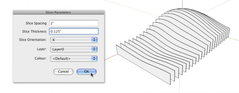

3d to stack image by multiple automatic slicing.
Does anybody now software that can convert 3d image into stack of bmp image?
The software will automatically slice the 3d model. For example with the slicing plane parallel to xy plane, the model will be sliced every 1% of the height in direction of z axis. It will produce 100 image in bmp/jpg format, with different color to represent hollow and solid volume.
Latter on this images (stack of images) can be view using stack images viewer or can be use to build the model by using 100 cardboard, cut one by one and then stacked.
Already try so many software, manual option to slice it one by one so many time will took time and prone to error.
Anybody, pls :( ?

I don't know any way to do that, but if you are not familiar with it, you might want to investigate LIVE SECTIONING, a nice tool and way to browse through section views of your model.
thanks for the reply, this what I'm talking about, but with my version of sketch up, I'm fail to do that
http://blog.ponoko.com/2010/11/11/slice-your-3d-model-for-lasercutting/
live section still requires manual labor :( but I'll google it, to see what can I do with it.
many software can export to .stl for 3dprinting. the next step is print it to jpg, sort of print document to pdf/jpeg in wordprocessor, but I'm also can not find software that able to do that.

the sketch up method is also work, took time to find the correct plugin. but so far with sketch up, i can only slice it up to 20-30 slices without crashing the software. with 123D, i can slice up to 200 part, but the software will be busy for 5 minute.
Some other alternative,
1.http://www.freesteel.co.uk/wpblog/slicer
Pretty good in slicing, with .stl input and .bmp output.
2.http://www.slicer.org/
Input file is .stl, but still figuring out how slice the .stl file (because it's recognized as model, solid model)
3.http://www.evilmadscientist.com/article.php/slicingstl.
Using POV-Ray. have not try it yet.
