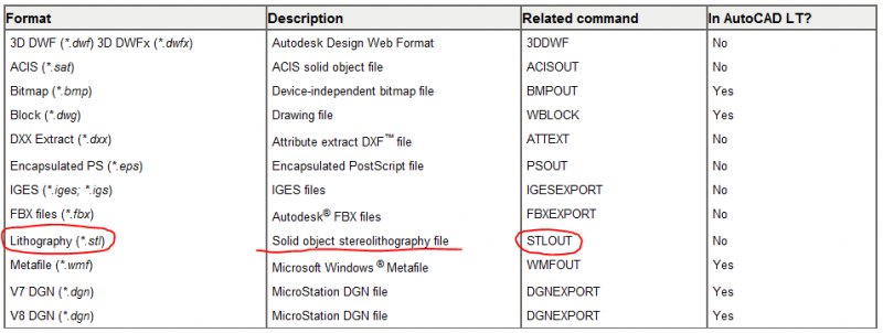

ReMark Posted February 6, 2013 Posted February 6, 2013 PALynch30 posted the following. " I need to get the model into a .stl format so he can get it prototyped." Maybe I misread that? Quote
PALynch30 Posted February 6, 2013 Posted February 6, 2013 CIVIL 3D does .stl with no problem. The second drawing I attached does have the correct demensions. The first drawing does not match the second because I had no idea what I was doing. I do need the object to have the dimension properties of the second drawing. Quote
ReMark Posted February 6, 2013 Posted February 6, 2013 In that case if the first drawing was used to create the object then it is wrong. I'm not finding fault with Titi I want to make that clear. Since you provided a drawing with dimensions and a cross-section showing the back of the object I felt it was important that the object be created from that information. That's all. Nothing sinister. Everybody cool? Yes, I figured you wanted a .Stl file all along. Quote
Titi95 Posted February 6, 2013 Posted February 6, 2013 sorry I'm wrong format Autocad few actually make the STL Quote
ReMark Posted February 6, 2013 Posted February 6, 2013 OK...I just didn't want to confuse anyone because there are such things as SLT files but they should not be confused with STL files. Quote

ReMark Posted February 6, 2013 Posted February 6, 2013 If working with the 3D solid your "cut out" can be made by subtracting a properly sized 3d solid or you can use the PressPull command (along with a 2D profile) to create the hole the battery would fit into. Quote
