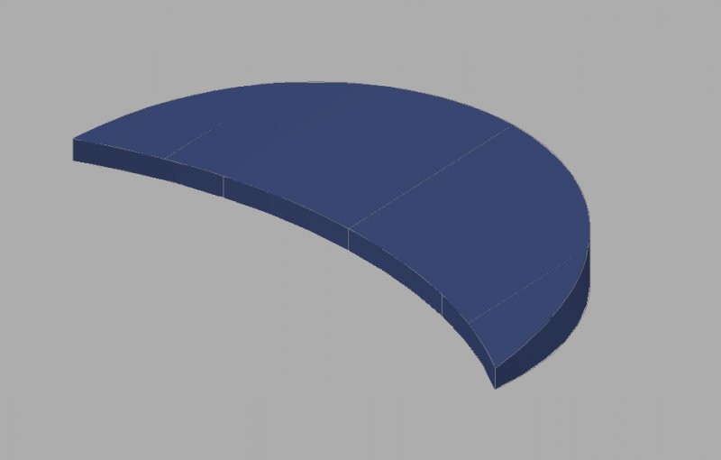

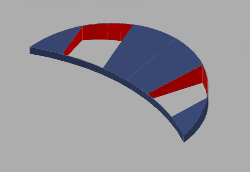

PALynch30 Posted February 6, 2013 Posted February 6, 2013 Ok. Yes those voids are intentional. Can solid be created and those voids still be in tact? Quote
ReMark Posted February 6, 2013 Posted February 6, 2013 I pretty sure they could. What is this object supposed to be? Upon closer inspection I see a couple of pieces of your geometry that don't quite fit right. Over on the left side for example the front vertical surface does not match up with the bottom surface exactly. Do you have any dimensions you can share with us? Quote
PALynch30 Posted February 6, 2013 Posted February 6, 2013 Honestly, I have no clue! A friend on mine said he had this invention he thought of and gave me a rough sketch. I didn't ask, I just told him I would try to help and if he made it big he had to buy me a car! I'm just trying to figure out how to take all those misc surfaces and combine them into a solid. Quote
ReMark Posted February 6, 2013 Posted February 6, 2013 Give us all the angles and dimensions you were working with. See my previous post too. Quote
PALynch30 Posted February 6, 2013 Posted February 6, 2013 Sorry I didn't read your entire post. I am uploading another dwg Quote
PALynch30 Posted February 6, 2013 Posted February 6, 2013 Hopefully this will help a little. All the dimensions were just roughed in and are not exact. I had a real problem trying to extrude the surface and get the gradual slope from back to front. Not an expert but I think this was a pretty challenging object to start with..... CombineSurfacesToSolid_Revised.dwg Quote
ReMark Posted February 6, 2013 Posted February 6, 2013 Well there are some differences between what you have constructed in the first posted drawing and what is called for in the second. Things don't match up exactly. Example: the height at the back should be 3/4" but it is slightly less and this is at what should be the high point of the object. Quote
ReMark Posted February 6, 2013 Posted February 6, 2013 OK. Here is your base object done as a solid. Now we need to create the voids. Quote
