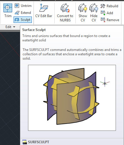

JD Mather Posted May 10, 2012 Share Posted May 10, 2012 Did 2011 have the Sculpt tool (I don't know the command line command). This tool "flood fills" an enclosed set of surfaces with solid body. Quote Link to comment Share on other sites More sharing options...
ReMark Posted May 10, 2012 Share Posted May 10, 2012 Is this more like you're interested in? "Flood fills"? Never heard of it. I'll have to look that up. Thanks. Quote Link to comment Share on other sites More sharing options...
JD Mather Posted May 10, 2012 Share Posted May 10, 2012 There is no function like you describe to turn an enclosed space into a solid in AutoCAD. Wrong answer - if I follow the problem description. I think this might have been added in 2012 on the Surfaces tab. Quote Link to comment Share on other sites More sharing options...
ReMark Posted May 10, 2012 Share Posted May 10, 2012 No cause to get pushy there big guy. You're talking about SURFSCULPT command? never knew it existed until now. Normally I don't work with surfaces. Quote Link to comment Share on other sites More sharing options...

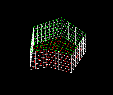

ReMark Posted May 10, 2012 Share Posted May 10, 2012 I doubt that he's gone. > Here's a six sided object created from a combination of surfaces and meshes. Quote Link to comment Share on other sites More sharing options...

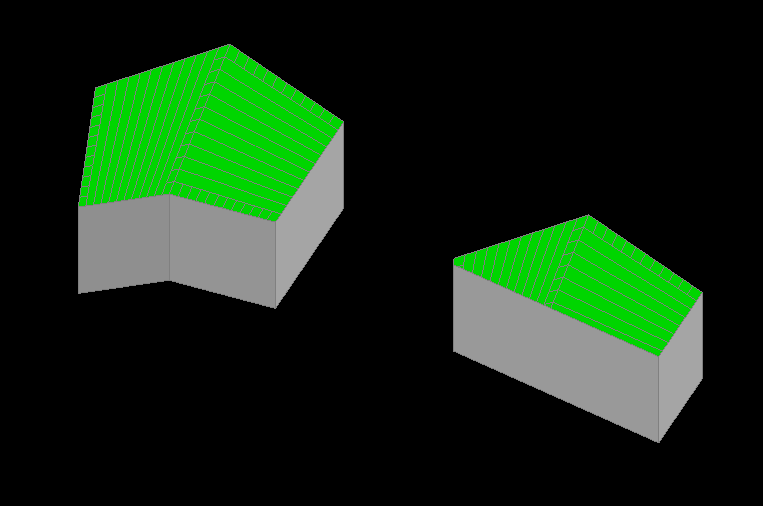

ReMark Posted May 10, 2012 Share Posted May 10, 2012 Here is the same object converted to a solid using SURFSCULPT on the left. On the right is the same object but it has been sliced. So, bottom line...JDM is right, there is a command that will do what you want and I was not aware of it. Is everybody satisfied now or do I have to thrash my chest with birch branches too? Quote Link to comment Share on other sites More sharing options...
