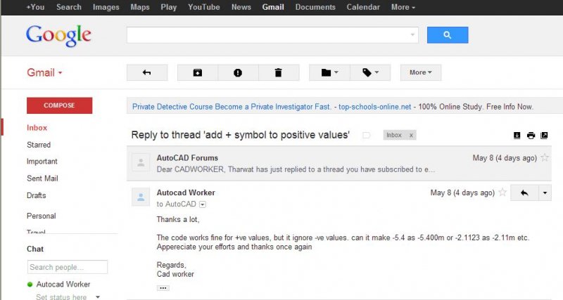

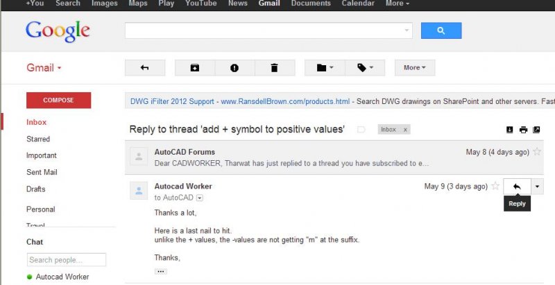

Why should we donate our precious time to you, when you cannot even spend the time to reply to your other threads?
1+ :thumbsup:
and his name is CAD WORKER, that doesn't want to do anyponys drawings? pity.
I shall reply to other post now onwards, just I have very little access to internet from office. Just could not reply yesturday. But I have replied to tharwat through my e-mail.
Sorry once again
and thanks
When did that happen ?
Tharwat, Iam sorry.
Anyways if you have not recieved my replies. Might have something to do with administrators or else?
I thank you many more times for your support.
Look at the attacments.
It is Ok my friend .
