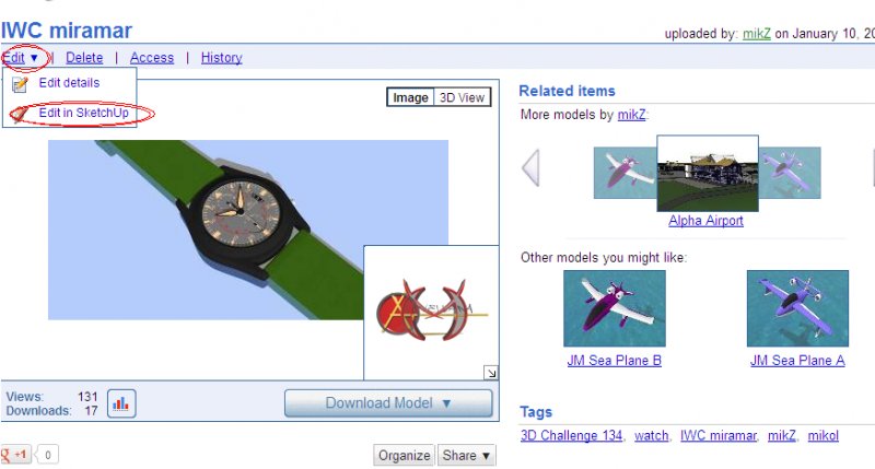

2. If you have deleted the file from hour computer, you can always download and edit it in sketchup.
just click the edit drop down menu (which is located just below the title of your model) and select edit in sketchup. 3d models1.jpg
