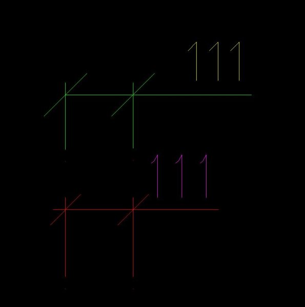

Just wondering if anyone can please let me know what dimension setting controls the distance in which dimension text is offset when it doesn't fit between extension lines.
Please see attached image for example.

That GAP is controlled by the size of the ARROW in the dimstyle. If you override the text location (MOVE TEXT ONLY) you can put it wherever you want to. If you hover over the blue grip in the center of your dimension a drop down menu will appear, select MOVE TEXT ONLY, then you can put it wherever you want to. :)

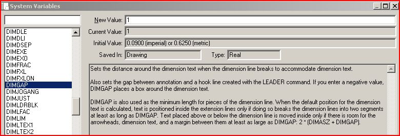

DIMGAP is the real key in the software, although the size of the arrow factors into the total equation as shown in the second attachment.

I understand i can move text manually, but it is really not practical for my situation.
I played around with the DIMGAP variable, and now i realise that is also controls for far from the baseline the dimension text sits - which i would rather not alter. Are you aware of any other way to reduce this GAP without changing the arrow size, or moving manually?
Also... What is that "System Variables" dialogue box? Looks pretty handy.

The DIMGAP variable setting CERTAINLY DOES control the DIMENSION TEXT OFFSET, which you can also specify on the TEXT tab of the MODIFY DIM STYLE DIALOG, as shown in the image.
If you enter SYSVDLG at the commandline it will call up all of the system variables available in the software, and what all of the available settings do.

I hate to be argumentative - but i think this DIMENSION TEXT OFFSET setting is the DIMGAP variable. They affect each other (or are the same thing).

I stand corrected, and should I choose to disavow the truth in pursuit of some vain glory, that would be pretty sad, wouldn't it?
I always set it in my DIM STYLE, rather than through the system variable dialogue, so had never noticed the connection.
When I read the description, it did not appear to be the case, but having just checked, I concur whole heartedly with your assessment.
Having just reset my text offset to 3.649 in the dimension style dialog and then checked my dimgap, only to find that it was 3.649, I think we can pretty safely surmise that you are right, and I was mistaken. :beer:

I believe Dadgad got it right with the first sentence of the first reply. AutoCAD draws the arrowhead, then adds a "tail" that's at least as long as the arrowhead block, then the text begins. The only option that I'm aware of to move the text closer to the extension line is to use a smaller arrowhead, or move the dimension text manually, as suggested previously.
Hi nestly,
thanks a lot for the reply. After doing a little experimenting, it does seem that the DIMGAP variable and the arrowhead size are the only ways to influence this gap (except manually moving text).
Thats a bit of a drag, because I would rather not reduce the DIMGAP or the arrowhead size, when this gap needs to be reduced, I have been moving the text manually - but that is not always required.
I was really just hoping there would be a quick fix - directed only at the dimension offset, without affecting any of the other dimension properties.
