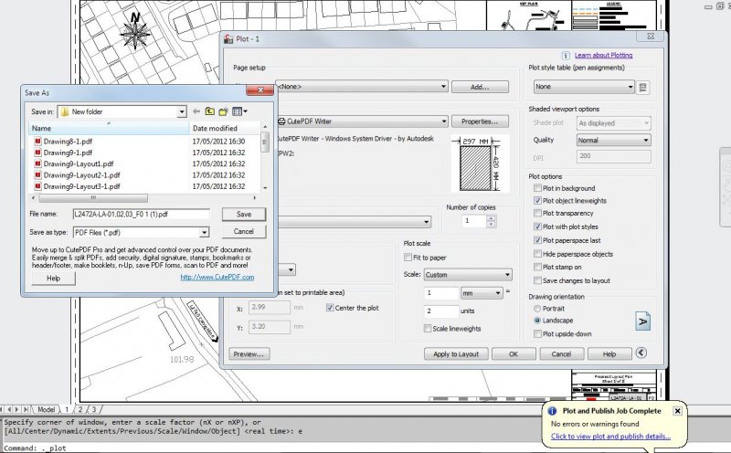

I have cutepdf printer installed and am using a lisp to print a pdf copy of a drawing. This has been running for a few years now without problems. I took the code that Bigal provided above and modified it to create a batch plot for pdf's. The problem I had was that the paper size in the "dwg to pdf" was not allowing our sheet to fit on the page even though it using the cute pdf. I modified the "dwg to pdf" to included our paper the same as the cute printer and now it prints fine but it is like it repeats the plot about 5 or 6 times for each layout and it goes into a loop and I have to esc out of it.
Could someone have a look and see where I am going wrong? Thanks.

The problem I am having with this is that it runs fine and launches the curepdf file save as window. And the autocad plot window reloads. I click "save" on the cutepdf window, which is not a big issue. Then I click plot on the autocad window but it plots the same layout. It can run like that for 5 or 6 times and eventually change the layout.
This is the cutepdf save window
I would appreciate it if anyone had any ideas how to get around this. Thanks.
I tried to incorporate a pause into the plot command but after the first plot it just stopped.
Use (layoutlist) for layout names
instead of repeat use foreach
(foreach name (layoutlist) '

Thanks pBe, I tried to incorporate your comments and this is what I have but what I have doesn't run. I have been looking and can't quite get my head around what I need to remove or keep.

What have I missed?
CCC_Sheet was an overhang from an earlier version and can be removed.

The code is supposed to plot all layouts to pdf using cutepdf printer. The problem was it was plotting the same layout over and over again.
(PlotReactorOFF) and (PlotReactorON) came from your post Woodman78
They are LeeMac's subroutines. I just removed them from the variable list and it works fine now. Thanks pBe.
Glad it helps Woodman78. keep on coding ;)
Cheers
