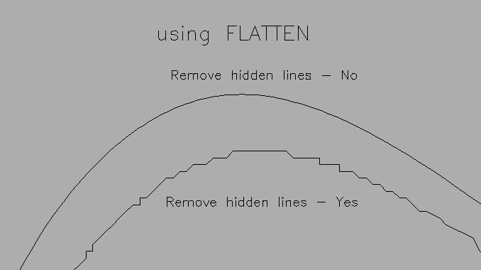

otsaki Posted May 5, 2012 Share Posted May 5, 2012 Hello folks, I am having a trouble in AutoCad, when i use FLATTEN, and then YES on my PROJECT that is done from ARCS and SPLINE FIT, all my project gets very EDGY and some lines are moving not properly, why? please help! Quote Link to comment Share on other sites More sharing options...

ReMark Posted May 5, 2012 Share Posted May 5, 2012 I guess it could go either way. By "edgy" you mean your lines are jagged when they print right? Quote Link to comment Share on other sites More sharing options...
eldon Posted May 6, 2012 Share Posted May 6, 2012 You may be having problems using FLATTEN on Splines. I always work by saying NO to the offer of removing hidden lines. If you say YES, then the lines get all jagged. Try both ways, and see how it turns out for you. Quote Link to comment Share on other sites More sharing options...
JD Mather Posted May 6, 2012 Share Posted May 6, 2012 When you run Flatten and then do a List - what type of objects are the result? Quote Link to comment Share on other sites More sharing options...

troggarf Posted May 8, 2012 Share Posted May 8, 2012 Change visual styles and see if the issue is still seen. You can also try the command FLATSHOT Quote Link to comment Share on other sites More sharing options...
