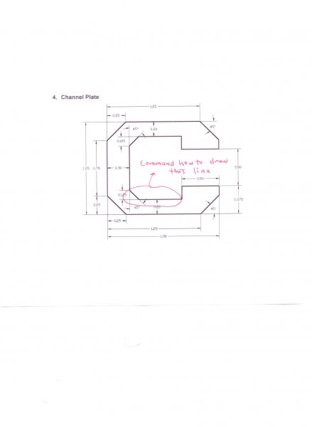

How to draw a line with given angle at the end? What is the command? can somebody help me i,m just a beginner.
Please check this CADTutor's tutorial about input on command prompt.
For your sketch, since the angle is 45degrees, I will use OFFSET to build the inside edges and use CHAMFER in next step to construct the sloped parts.
It looks like (only I can't read the actual dimensions) as if there are enough dimensions to be able to draw the figure directly, using relative lengths, as long as you remember that at a 45° angle the difference x equals the difference y.
